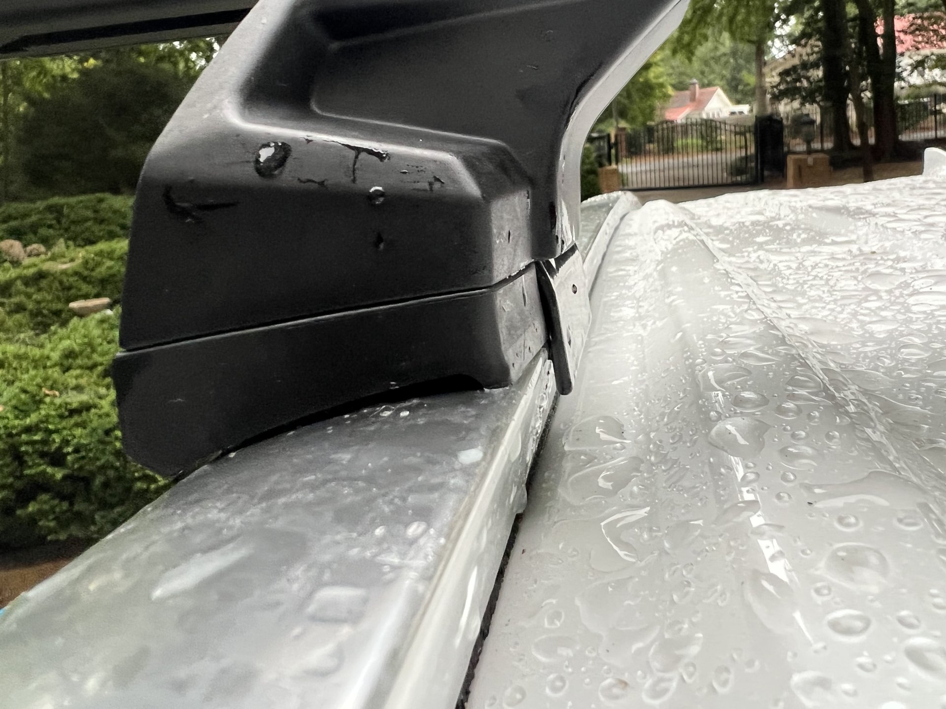

Hey, do you think this bracket secure? I don’t have any experience with installing a Thule cross rail system.
The bracket move when I attempt to rock it. I’m just concerned about the gap on the outside clasp.
I plan on placing a Thule Motion XT L box on this .

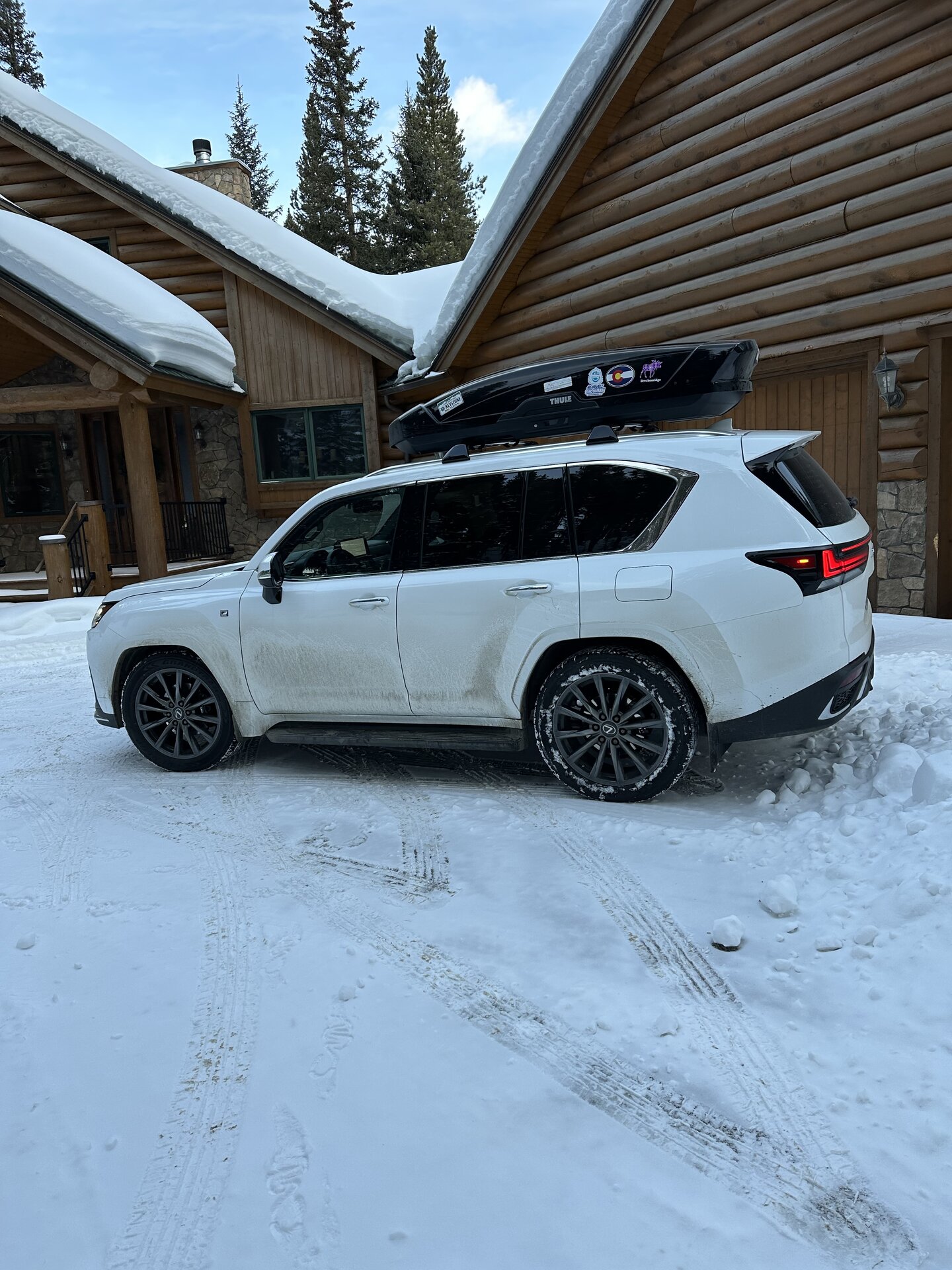

I’m not much help with your current Thule setup but I’m running a Thule motion XXL on the factory load bars. I had this same set up on my 16 Land Cruiser for a couple years without issue. The LX factory mounts are not as substantial as the LC but I’ve had it loaded up pretty good for a 3 hour highway drive without issue.
The lower profile look of the factory load bars combined with the fact Thule didn’t have an option out yet when I got my truck made the decision easy. The size is perfect for the proportions of the LX.
This was the only pic I could find on my phone.
Which thule foot kit are you using in this photo? I don't think it should have that gap..

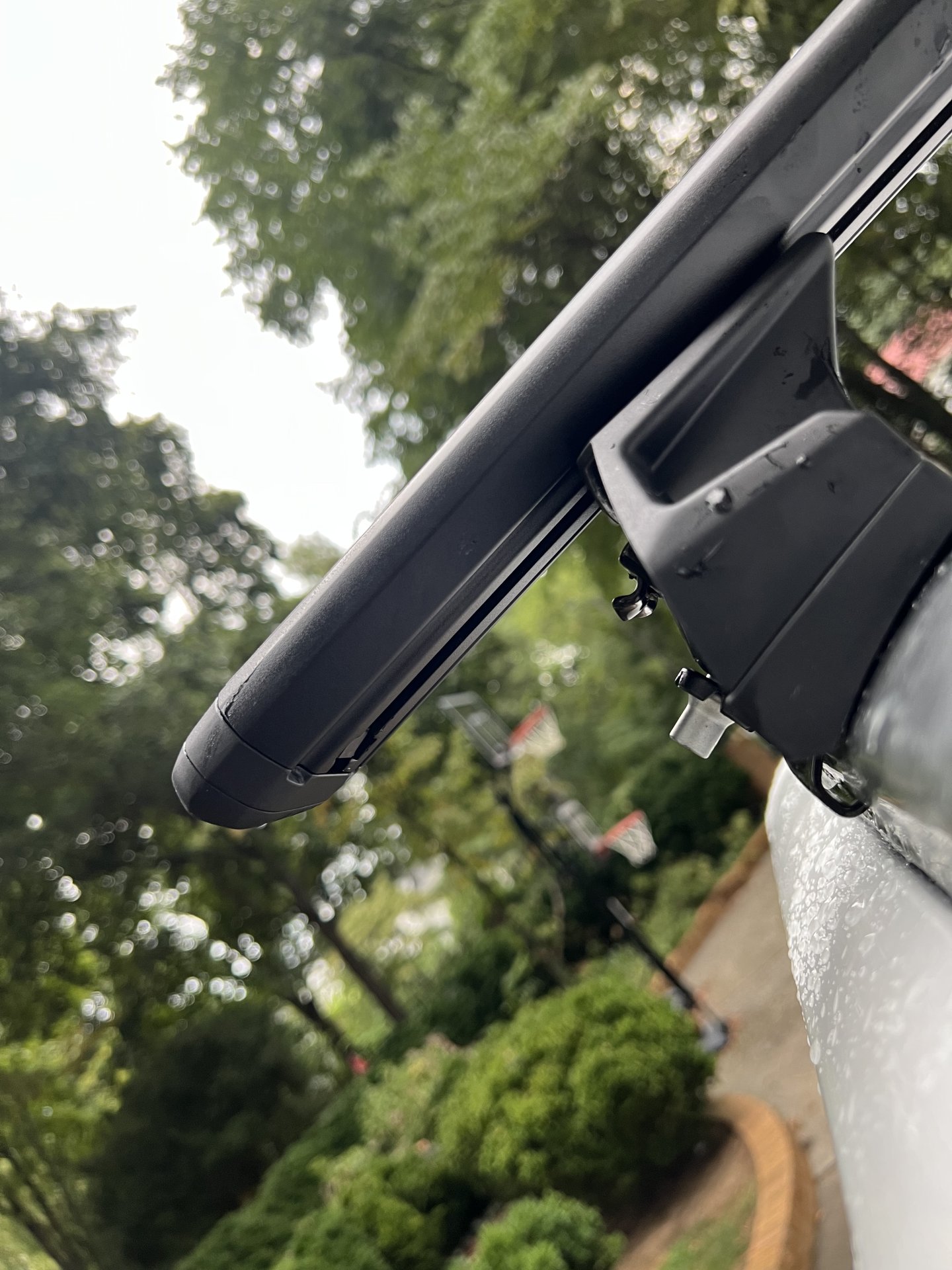

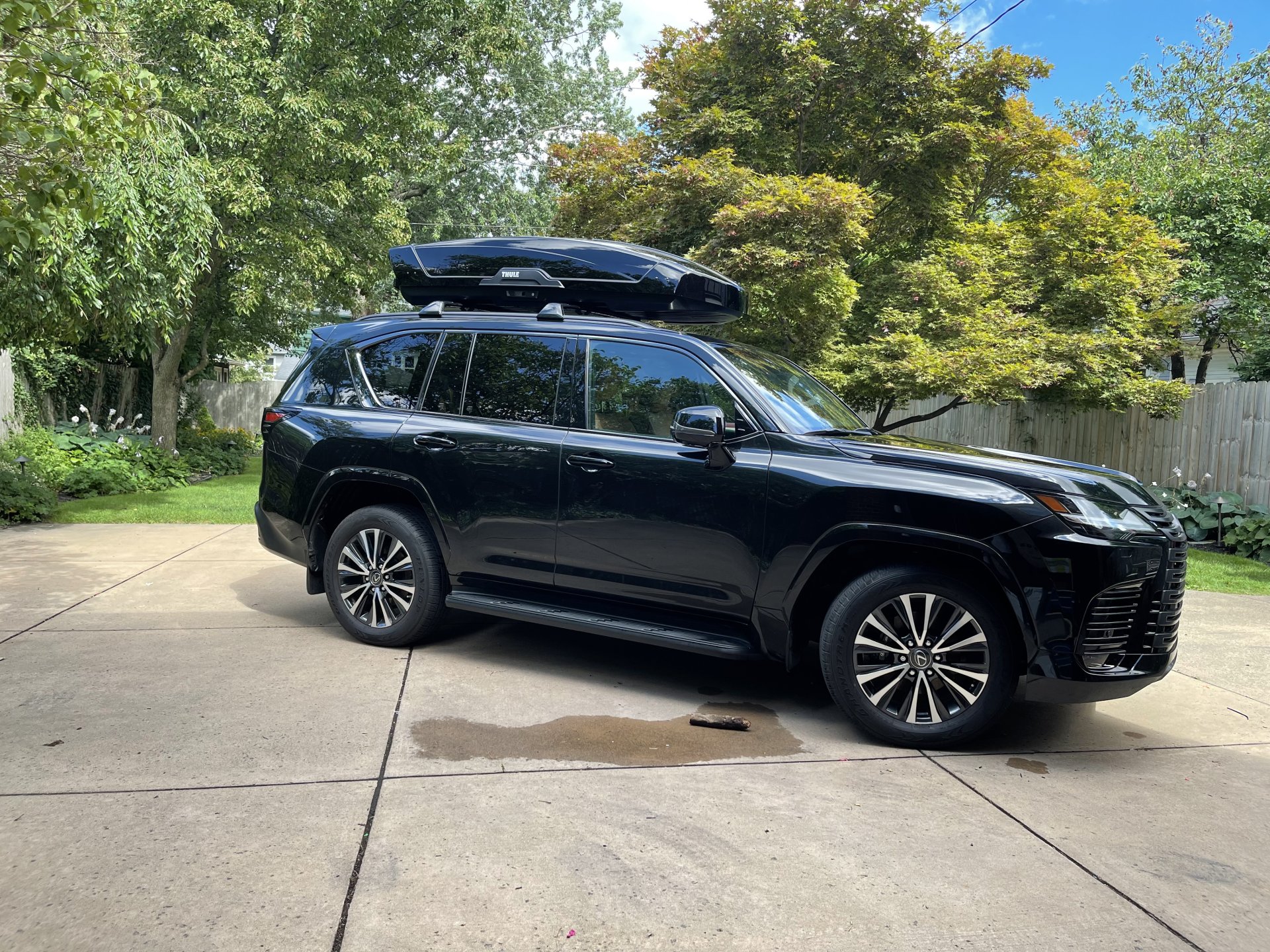

I just had mine installed, can you take a close up of yours please? I’d like to compare my feet to yours. And are these things adjustable, or set it and foreget it in one spot only? Front of truck is on your right
I just installed these as well. (the OEM ones). yours are on correctly, and you're right, they are not adjustable, as they they have two pins that slide into the dimples on the inside of you roof rails.
