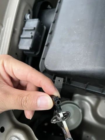

Thanks for the link I was able to buy the connectors. When I went to change out my low beam bulb the wire snapped at the connection from corrosion. Stripped the bad part and popped a connector on and my low beam is working again. :)
