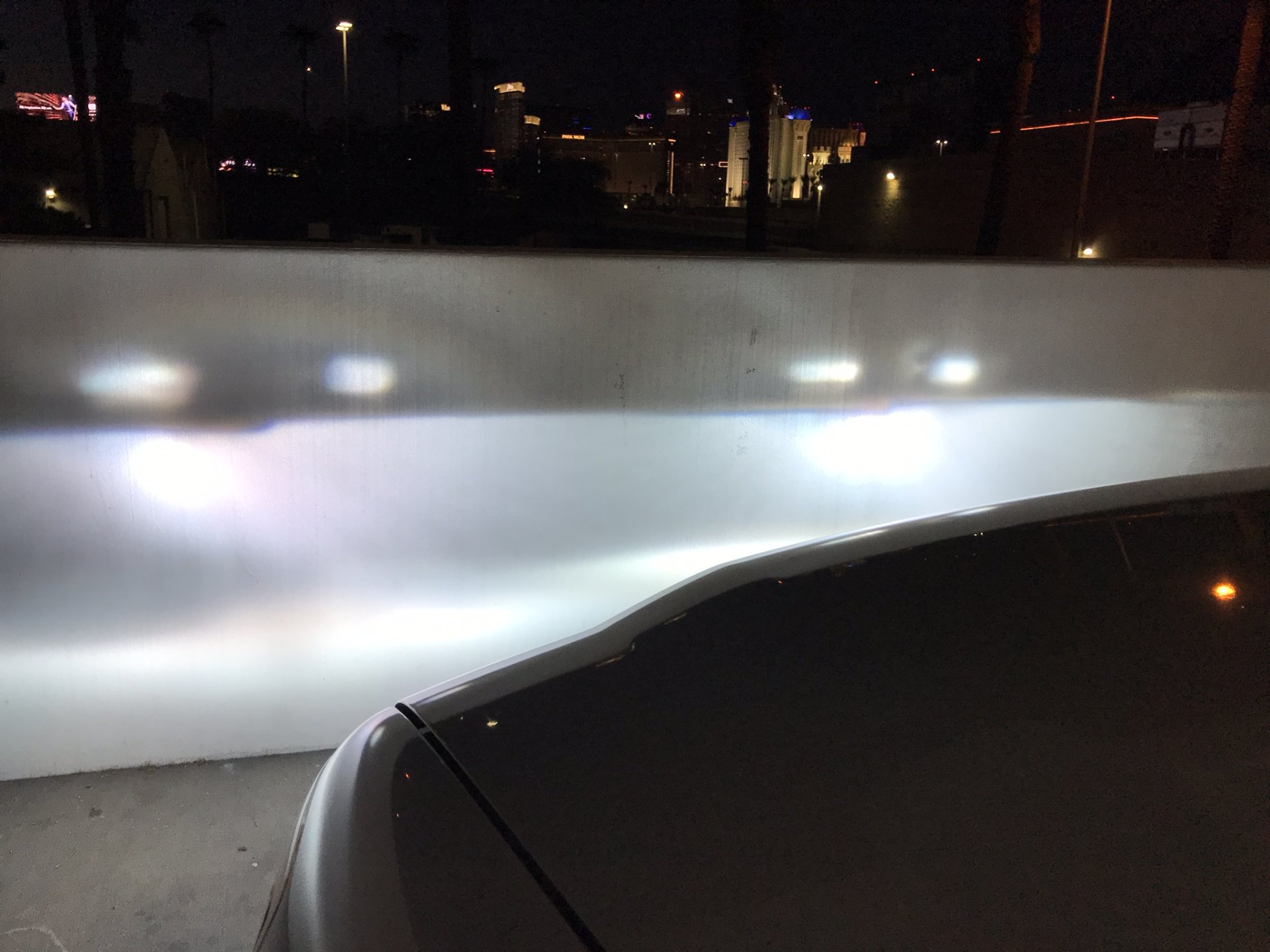

If anyone is thinking of upgrading their headlight bulbs, this might be helpful.
Left is 35W 5000k Morimoto HID from the retrofit source
Right is SaberLED ProX 55W Accu/V2 from DDM
I'm not actually sure which one I like better, the 5k should be better for visibility vs 6k. Seems the DDM has a tighter hotspot but not as much overall light.

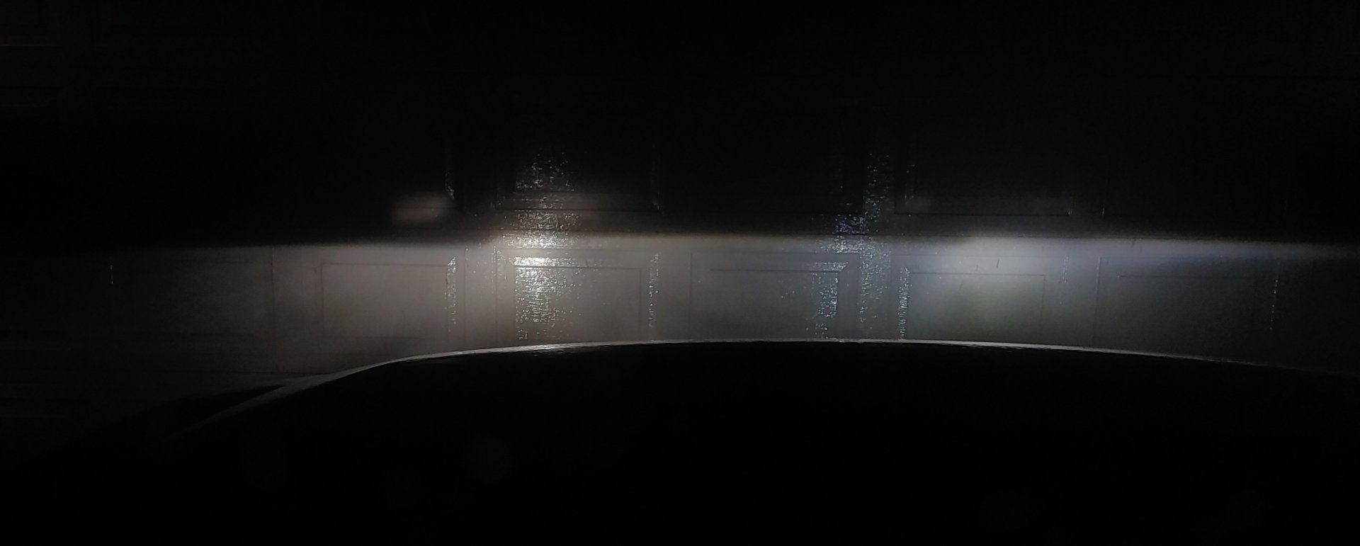

Higher color temp yields lower lumen rating.
This is a 50w Morimoto XB ballast on 6000 kelvin Morimoto XB xenon bulb with Morimoto harness.
I stepped down from an 8000k bulb / 55w no harness amazon kit to the Morimoto elite XB kit and the latter is definitely brighter.
I stepped down from an 8000k bulb / 55w no harness amazon kit to the Morimoto elite XB kit and the latter is definitely brighter.View attachment 2915769View attachment 2915773
You've got aftermarket projectors though so anything is better 😅
That’s your last step, if I can do it all over again I’ll go with the D2S projectors (bigger, brighter, more bulb options).
Did you need the Canbus decoders for the LED install? Impressive output from that those LEDs for the price. The 12.5k lumen rating for the pair is legit.
No, you do not need canbus for our vehicles. Works just fine.
