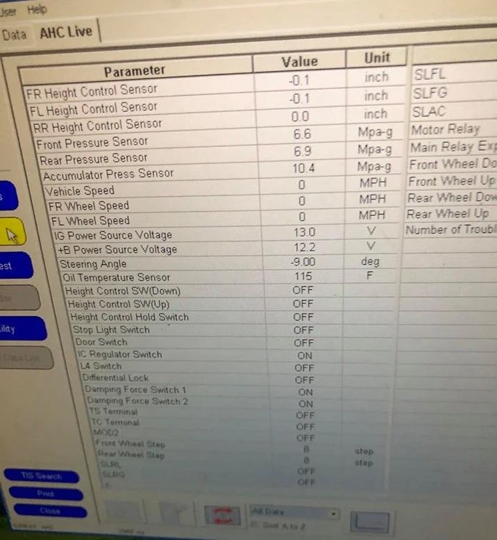

Just wondering if anyone has experienced this kicking in the rear when you go over a bump, it's the same sound/feel when you active the rear solenoid in active test via techstream.
If I'm in High mode it doesn't do it and if I crank up the rear sensor to a higher position it becomes minimal - much smaller kicks and but the back is a lot higher.
I've just put the new globes in - the King springs were in with the old system and the kicking wasn't happening then but the globes were shot.
I'm thinking its a rear sensor but just seeing if anyone has had this issue before...
Any help appreciated!
LX470 2001
King Springs KTRS-749
New pleiades globes
AHC Specs below

Off topic but your rear pressure seems high with King springs, are you carrying heavy weight in the back?
Nothing in the back.
I have boosted the back up a bit to stop the back clunking/kicking when going over bumps, I think this has added some pressure.

I'm surprised to see your rear pressure go up so much just by replacing the rear globes. Is there any air trapped back there in the globes/lines etc?
Possibly, I have flushed it a few times but think it's worth taking another look, cheers - any good tips in flushing air out of the rear?
Also rear was lower to the wheels with the old globes on, that could have affected the pressure but the change does seem a little too dramatic.
