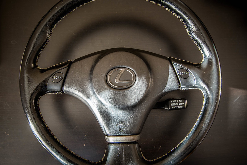

This might rain on my parade. I know I'm going to need to swap or re-pin the Cruise control but the horn is something I regretfully overlooked. I just got my IS steering wheel so I'm past the point of no return. I have an automatic IS300 steering wheel with the shift buttons on the steering wheel, I wonder what I could do with them?
I'll keep you all posted if the IS300 wheel becomes a viable alternative.

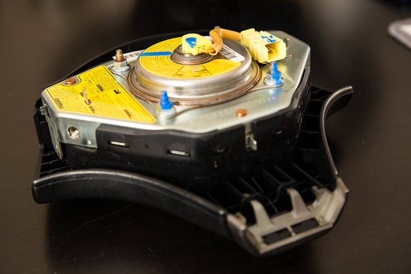

Rear of the 99-02' IS300 Airbag - single stage
20121203-IMG_2086.jpg by RickaShay24, on Flickr

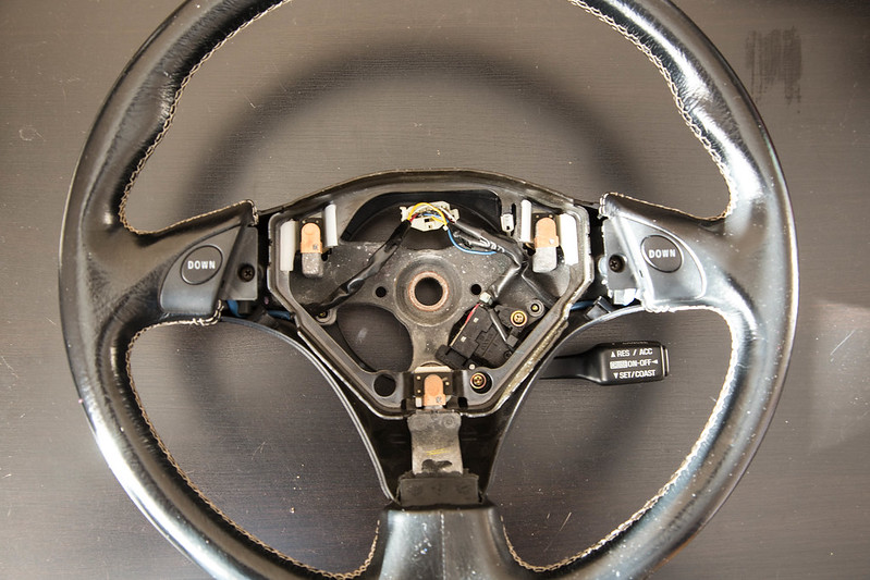

Guts of the IS300 Wheel - you can see the wiring for the up/down shift buttons running in with the Cruiser Control Module wiring.

I sure hope I can make it work, it's very similar to the MKIV Supra steering wheel!
20121203-IMG_2088.jpg by RickaShay24, on Flickr

Steering wheel is on. Cruise control harness plug is identical to 80 series one and plug right in. However the wiring is pinned differently so I'll be re-pinning if I can find a diagram or swapping the LX450 staulk to the IS300 wheel. Airbag plugs dont work together but I am going to order a OEM adaptor PN: 09082-0076 and see if that will make them compatible, and it should. Will update with more info as it unfolds. Love the wheel, slightly smaller diamter than the facotry LX wheel.
