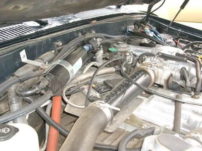

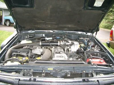

Still looking at it and trying to figure out if I can somhow plum the YORK in there. As it would be the preferable way to go.
i don t see the dual batteries being an issue not sure where your turbo is routed (likely in the way as you said) i would be curious to see some pics posted up of your engine bay? maybe in another thread?
this is all I've got handy..............

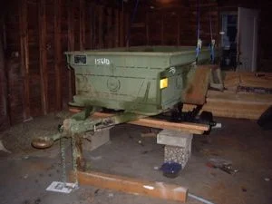

some pics of the new trailer i just picked up. it will soon be the home of the ezzi awn tent and the stove that way i can take some weight off my truck since i use it as a daily driver

The engine bay with the TURBO belongs to me.
