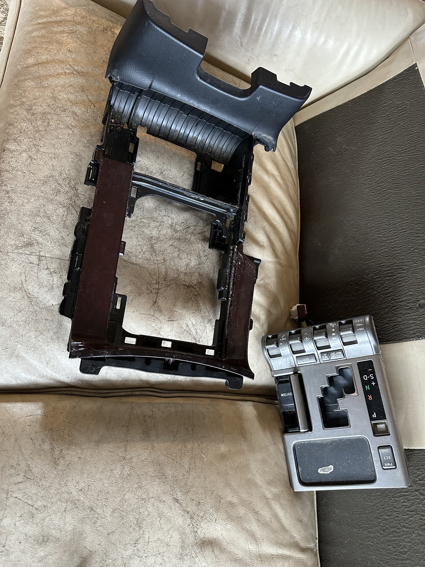

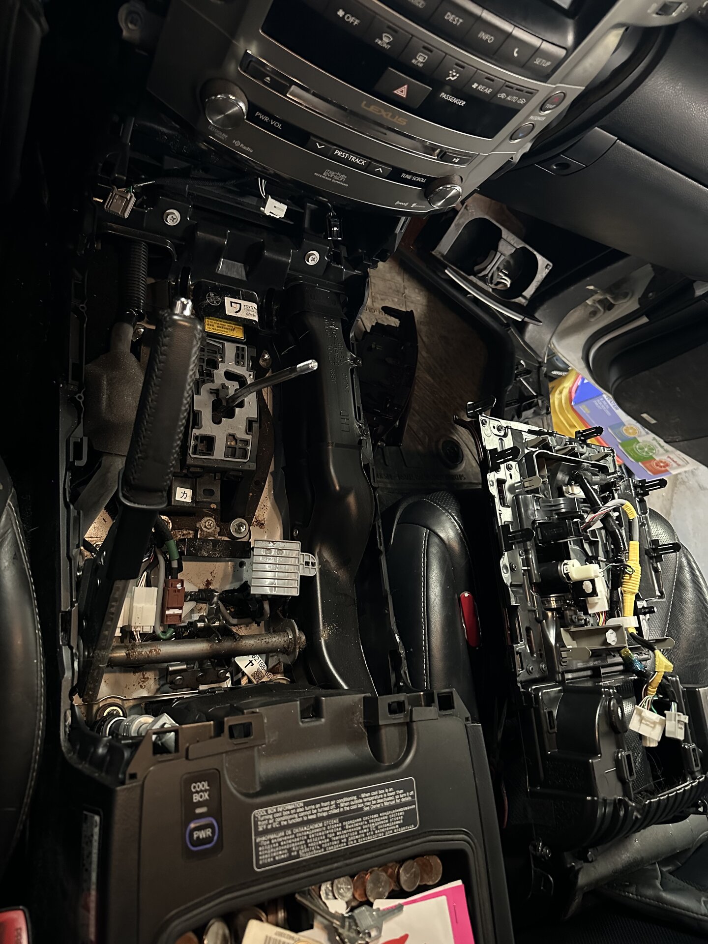

Posting these in case they're helpful to anyone:
Here's the back of the main trim - after the other components are off (wiring harness, shifter base trim, AUX/120w Power Socket). The harness will be along the top and going down the left side here, attached w/ plastic plugs. At the bottom, there are 5x screws (removed here) holding the switch assembly (4 Lo/Hi, AHC, etc.).

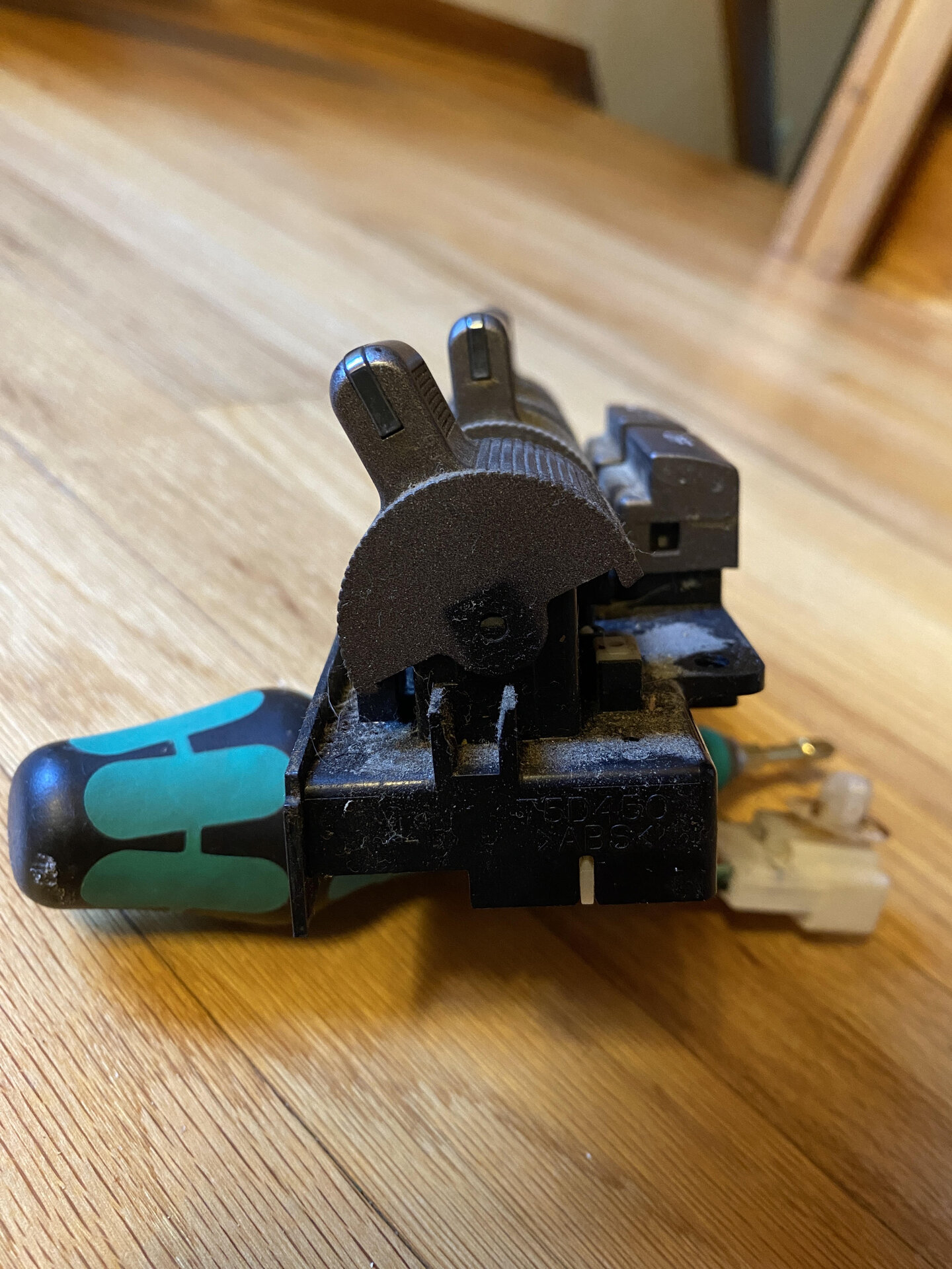

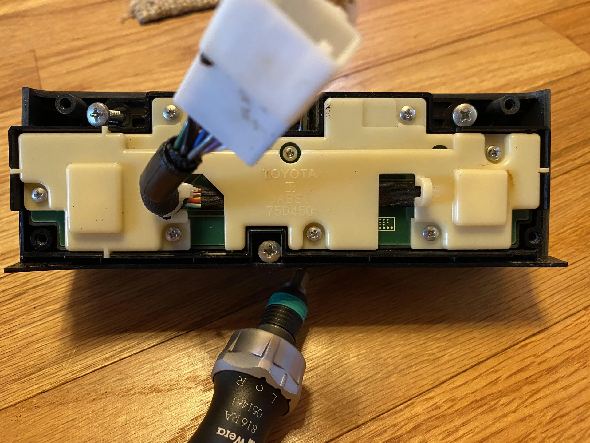

Here's the switch assembly. There are 3x screws to get the cover off:
Here's the switches without the cover. (The 4 Hi/Lo one, not pictured, connects differently since it pushes in):

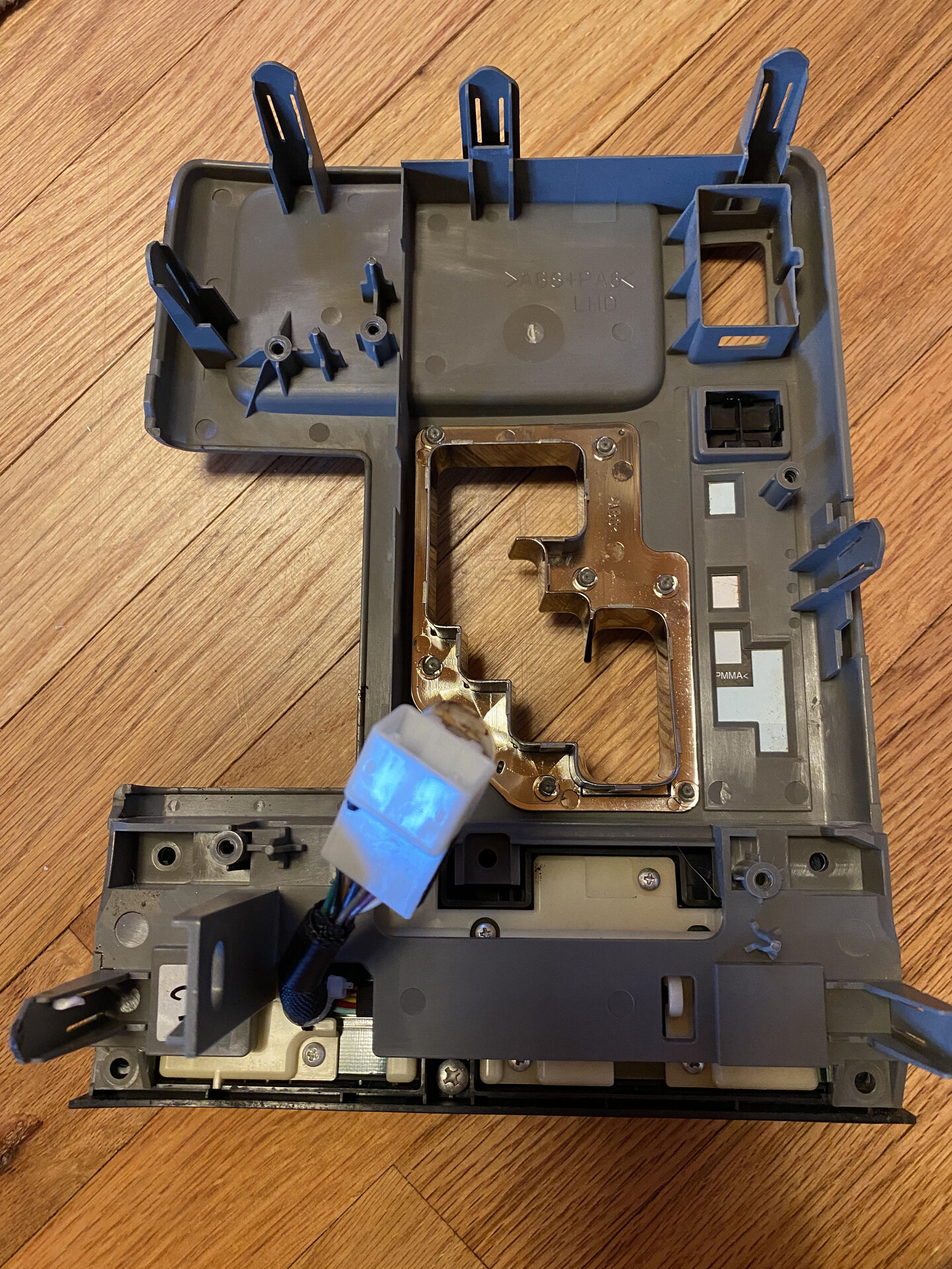

Here's the shifter base trim (removed from the main trim piece in the first image):

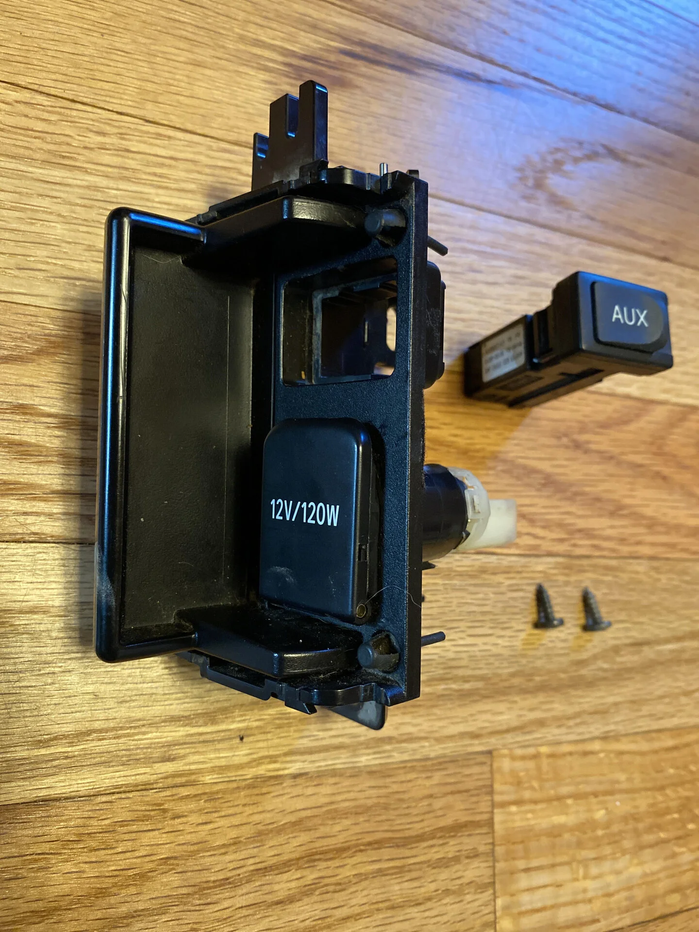

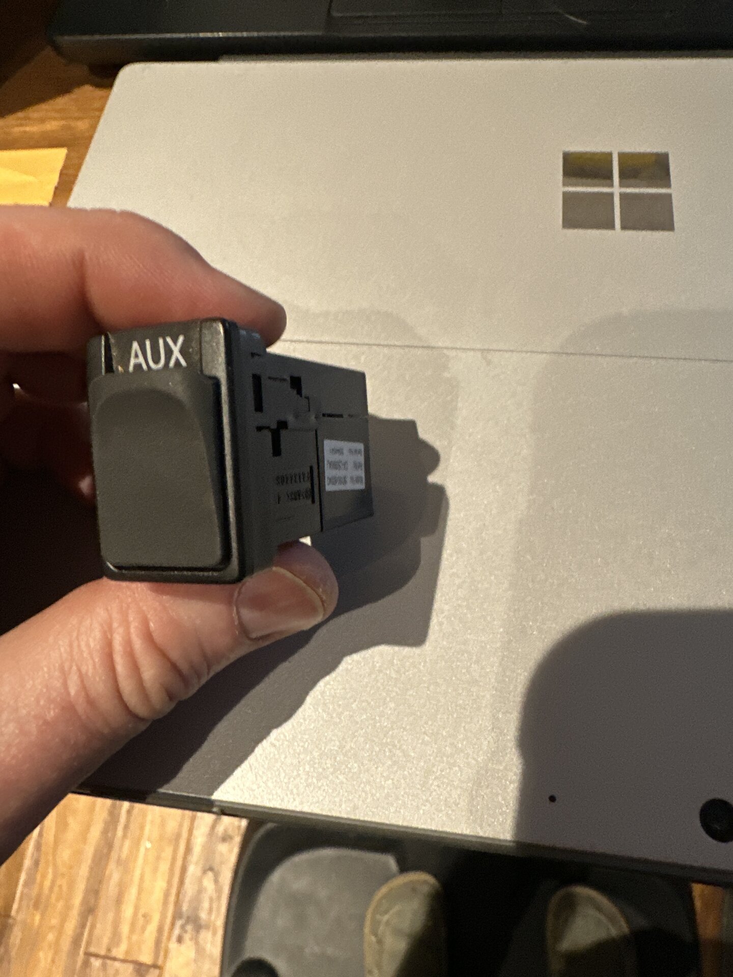

Last, here's the AUX/120 power socket piece (removed from the main trim piece in the first image).
I did this to clean everything out and replace the power socket. But the power socket + sleeve are the only thing I can't figure out how to disassemble all of the way. It has thick tabs that look one-way only (they don't depress).

Were you able to sort out the power supply breakdown? My kid stopped functioning today so while I’m in there I was tempted to try to move the wired apple carplay connector to this location.
Yes - the 12V plug comes apart. The metal piece separates from the black plastic lid piece, and when both are together they're stuck in the console panel. I already have it in there, but it's easier to see if you order the replacement pieces.
From what I remember, do not put the new pieces together outside of the console panel - since they are difficult to get apart, but it should become clear how they go together looking at them.
Here are removal instructions: Power Outlet Socket Cover Replacement: I Am Looking to See How to ... - https://www.2carpros.com/questions/power-outlet-socket-cover-replacement ... 3. REMOVE POWER POINT SOCKET ASSEMBLY (a)Disengage the claw and remove the power point socket assembly. Pic 2
4. REMOVE POWER OUTLET SOCKET COVER (a) Disengage the 2 claws and remove the power outlet socket cover. Pic 3
When you go to install them (after removing the old pieces), I believe you insert the plastic lid piece from the top side of the console panel and the metal piece from the bottom side.
85535-06020 is the plastic cover surround and lid: https://www.amazon.com/gp/product/B00TNNS2VO/?tag=ihco-20
85530-06030 is the metal piece that clicks into it: https://www.amazon.com/Toyota-85530-06030-Outlet-Socket-Assembly/?tag=ihco-20
