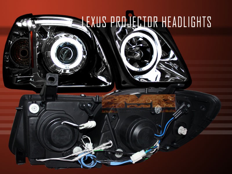

to me, all the connections look plug and play from what I recognize in this picture
See notes in Orange below....

Was the installation "plug and play" or did you need to splice in wires?
Installation was simple. However, be very careful with pulling the thin trim piece around the lights. I only had to splice the lead wire for the halo part to the parking lamp light wire.
Do the HALO lights work with the daytime driving lights?
I have mine wired to the parking lamps and they stay on with the full light. They look exceptionally good when just running the parking lamps during the day. The DRL are still on during this time. I need to take some pics and post.
