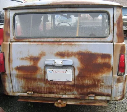

what kind of Toyota emblem goes on top the latch/license light ?
and did all LV rear decks have the the 2 emblems ?
this one does not have the mounting holes ???

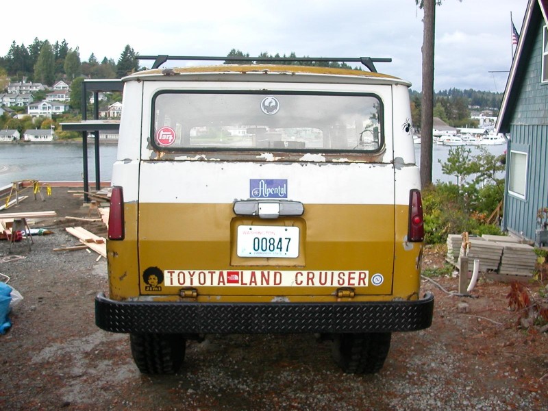

Pull that plate off and you will see a "Toypet" engraving. Those two little screws.
As far as emblems go, mine has the "Toyota Land Cruiser on the left and "4wd" on the right. Older ones had a sticker that said "Toyota Land Cruiser" on the bottom. Foxfab has made repos of these decals.

original on my old Jimiwag......when the PO painted the body they painted around the decal ;)
