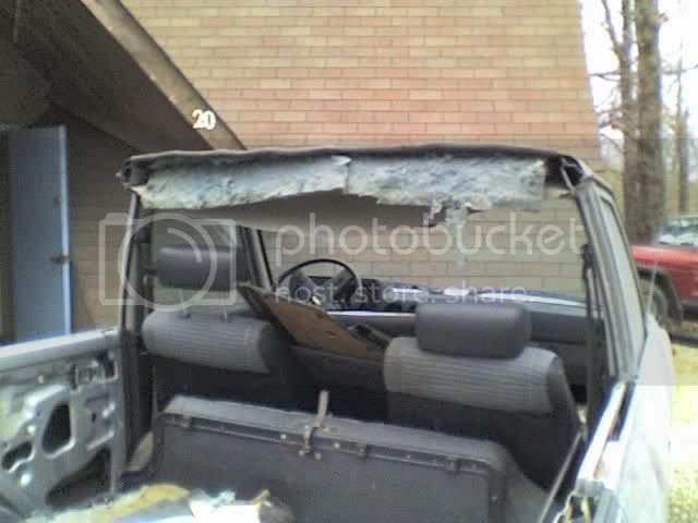

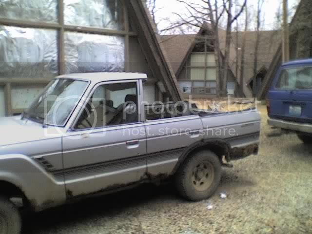

Pictures
Okay....today I didn't get much done as me and wife did alot of running around town and everytime I would start to work on my truck a neighbor would stop by to chat about the project or life in general, which is okay by me. Not only do I get to explain the project I also get to hear their recommendatoins and thoughts along with helpful general knowledge that has nothing to do with the project at all.
What I did get done was just simply taking some more paint off of the body and taking more exterior parts off like the vent on the pass side along with the exterior trim on the Pass. window. Also took off the rear views.
Mostly this post is just for the pictures that everyone wanted yesterday. I will apologize in advance for the pictures.....they were taken with my phone.
The first shots are all pretty self explainatory(SP):
lunyou
And some more:
And this final one is so SPEEDY(my blue 60) doesn't get jealous.

I was wondering when someone would ask about that....one of the POs decided to spray that insulation, the type found around pipe fittings, down in the space between the rear quarter and the inside panel. I am not completely sure if this was done before or after the panel rusted out. It is in both sides but the passenger side's quarterpanel isn't rotted out like the driver's side.
I will remove it before to long so that I can start the fiberglassing. Right now it is giving my quarters a little extra stability for when i decide to trim some more. And Lord knows it needs some trimming.

damn thats some bad rust. gonna chop the quarters back? if its gonna be a wheeler it might be a good idea anyway. whats the cage gonna look like (photochop?)?
wow, you cut the top without removing the rear side windows! You could have kept a lot of body stiffness had you left the window sills, oh well. Time to break out the sheet metal and welder. Or I guess you could just fill all the voids with more of that foam :)
Yeah i cut the top out with the windows. I didn't know I should take them out.
I really wasn't a fan of the body line that would be left if the window seals remained. That foams is the devil in my book and will be removed as soon as get to to working on the panels.
It is going to be a wheeler and I am already trimming the body in my mind trying to get the look I want.
When I get home I can try to post a sketchup of what the basic roll cage is going to look like. It hasnt been triangulated yet but that is pretty simple stuff.
