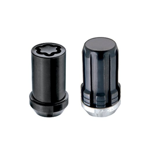

You get what you pay for, I guess. The lugs I linked to by McGard have a rotating attached washer at the mating surface of lug and wheel - it is the silver part in this pic:
Cheaper lugs, as you linked to, do not have this feature. The idea is that after the lug contacts the alloy wheel, if the mating surface does not rotate while being torqued, that mating surface does not get chewed up.
As with all things aftermarket, we are all free to follow Toyota's proven design ideas or go out on our own - I like the former. YMMV.
HTH
