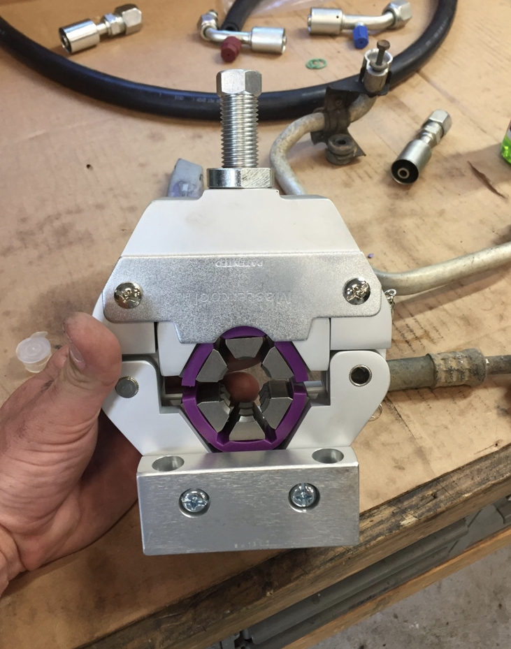

Do a search in the 80 v8 swap thread under my username. I’ve listed the part numbers and the tool (only $125-150) to make what you need. Incredibly easy.

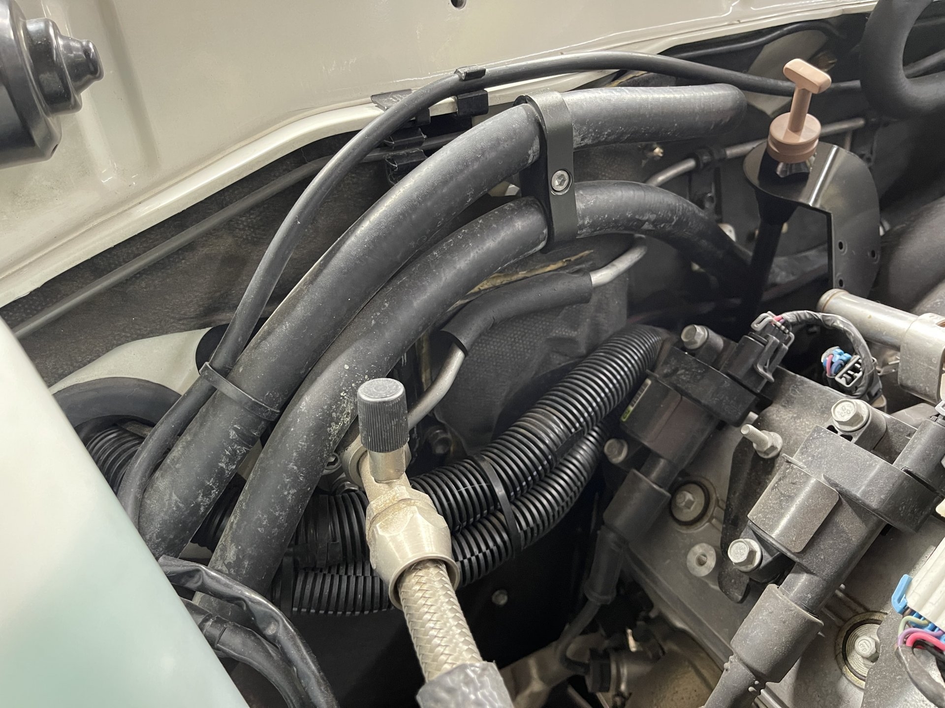

Here is the AC stuff I used. Cut the ends off the stock lines and used the factory ends that attach to the firewall and condenser. I adapted to the condenser side close to the core support.
______________________________________
-This is all from coldhose.com:
2-feet BH8 (#8 regular barrier hose)
3-feet BH10 (#10 regular barrier hose)
SB3002 12mm to #8 metric straight compression adapter fitting
SB3003 14.5mm to #10 metric straight compression adapter fitting
AA0738-AA0739 Denso 10S17F 10S20F Suction and Discharge Compressor adapters
(be careful on the next parts, there are lots of options for reduced barrier hose, aluminum vs steel, etc)
SB1313-3 45* female o-ring adapter to #10 hose with R134A suction port
SB1322-3 90* female o-ring adapter to #8 hose with R134A discharge port
Buy this tool. It’s awesome.

View attachment 2739339View attachment 2739340
were you able to keep the stock pressure switches?
