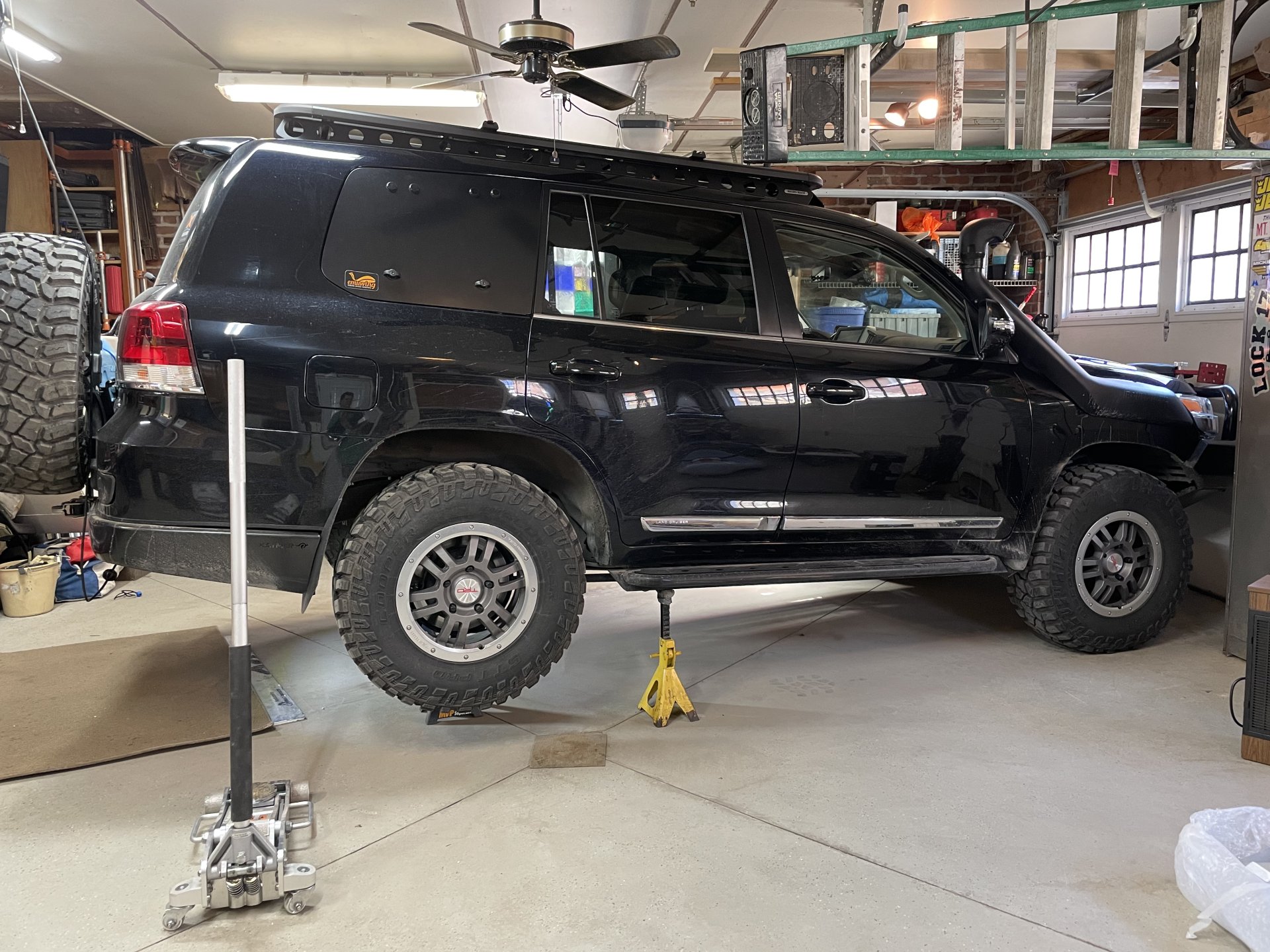

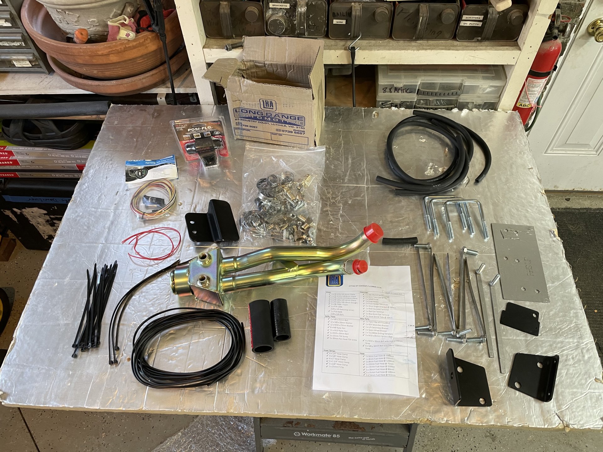

I did my 12.5 tank myself, with just hand tools and Jack stands. If you don’t know what you’re doing, the instructions can be a bit confusing on the first read through. I had my wife help at the actual hanging of the tank time- I bench pressed it up into place and she started the bolts. Not too difficult.

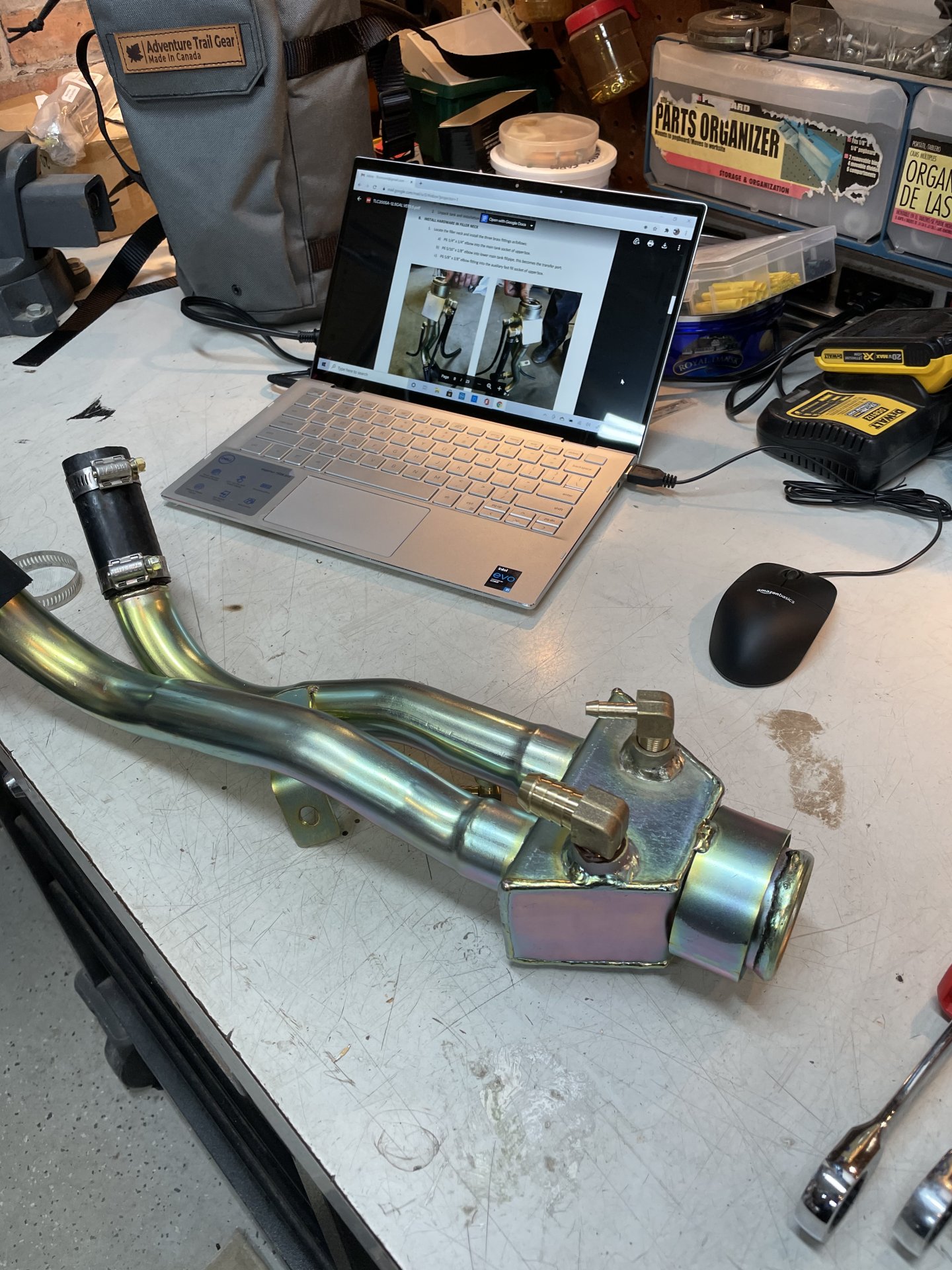

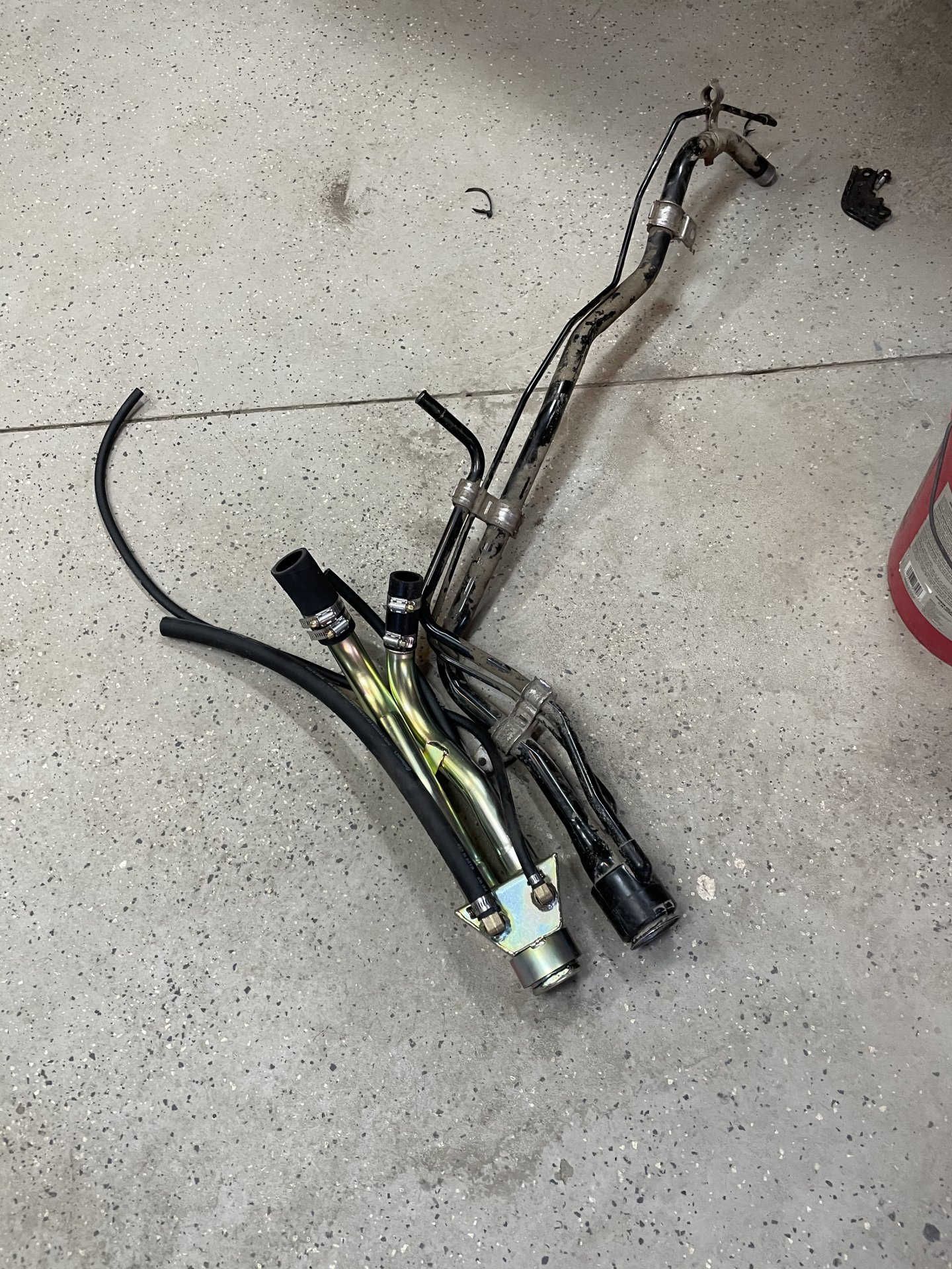

The only change to any of the factory fuel system is the new neck. Fuel from the LRA tank is pumped into the fill neck of the factory tank, so you should never have vapor, spill, vac codes thrown.
Measure the factory neck 3 times- then cut it long. I cut mine about 2” short and spent a whole day calling and running around to shops trying to get a longer piece of the metric hose to extend my f up.

If you can read directions, crimp a wire, twist a wrench, and hold 40lbs over your head for a minute or two, you can do this install in your driveway.
