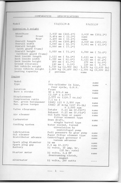

here are the specs from the 1964 intro of the 45LPB

Picked up some shocks at napa this morning. . Rears from fj 55 listing and fronts from fj 40. Less than 15 bucks apiece. Now after work I can see if they'll fit. Greenspan, are you saying that the front and rear are the same and work with all 40/45? and Landpimp, I couldn't see the info you enclosed. My computer doesn't show about 1/3 of photos and other info. hmmmm, maybe my kids have a block on it.... :D And I'll be on the lookout for a whaler. yeah, Bud and Sandy rocked in theirs! Now to figure out the shackles.
