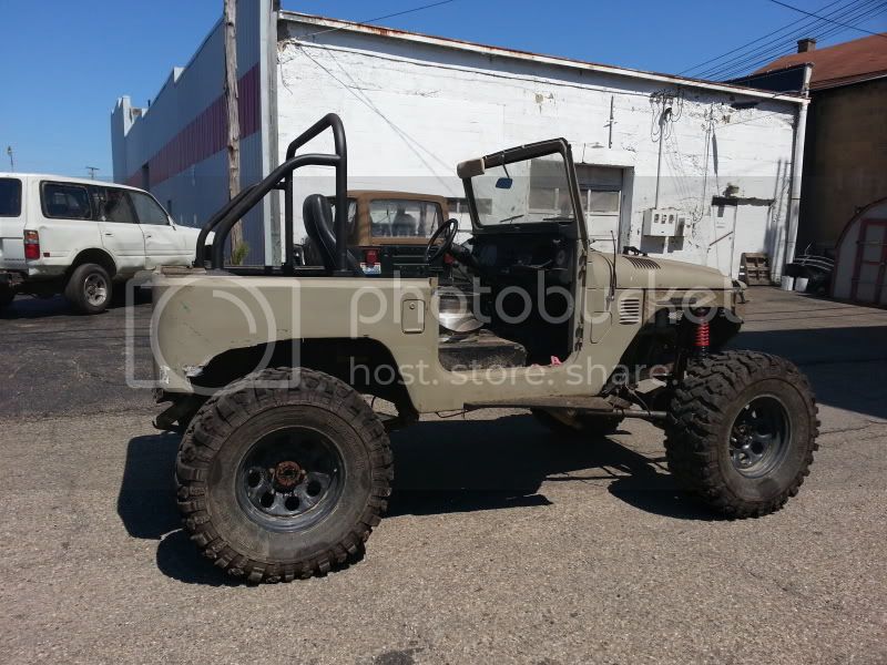

Just to give some resolution to this. Been trying to make some progress so I can wheel this thing before the end of the year.
I ended up at 22" on 37s. Nothing has been broken in yet and (as you can see) I dont have my top, bumpers, winch, or cage in yet so I expect it to drop another 2-3 inches. 40" Nittos coming tax time.
102" Wheelbase
Ruff Stuff 9.5" front axle/ 80 series FF rear
3 link 14" FOA coilovers
FJ60 Rear springs
