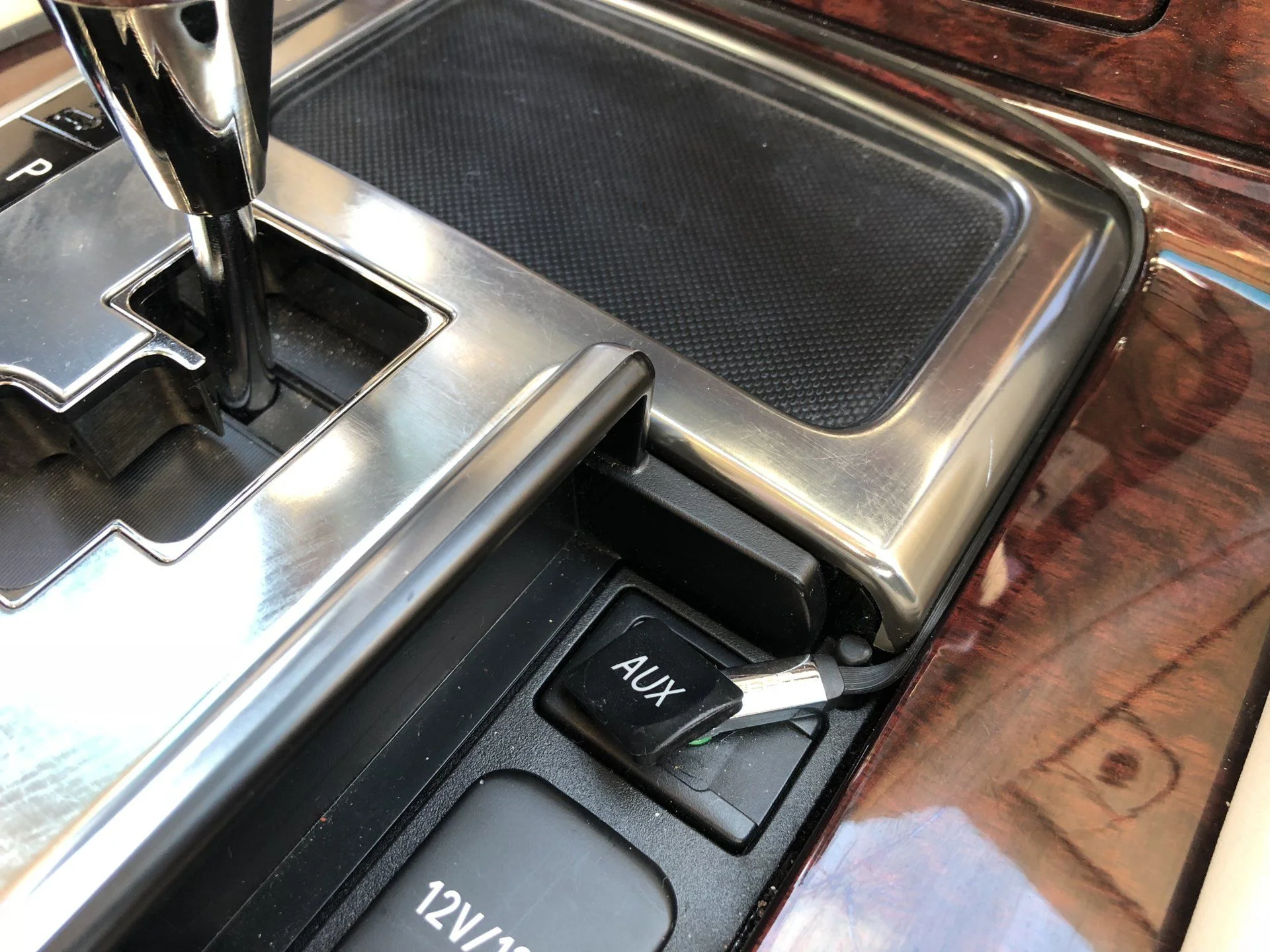

Now to hide the cable, just plug the 90 degree bend into the aux port and run the wire out the corner to the edge of the metal trim plate,and start wedging it between the wood and shifter trim. You can close the cover door for the aux port since the cable is so thin.
continue running it around towards the driver's side using a small screwdriver or pry tool to wedge it down just enough to hold it tight all the way around by the hand brake.

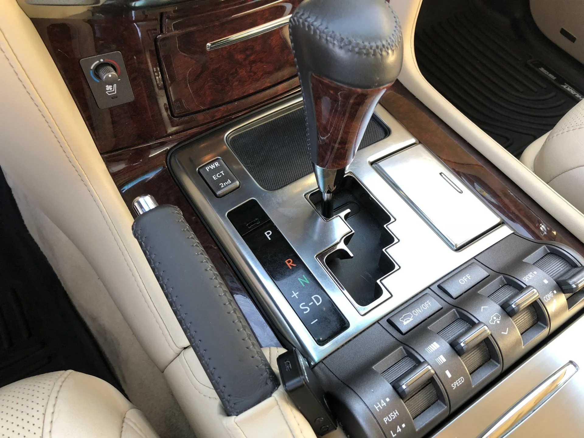

Once you get it all tucked in, hook up the adapter and it should sit right by the hand brake like this:
The power button and volume controls are easy to reach - normally I just turn it on when I get in and then push it down out of the way into the leather between the handle and center console.
