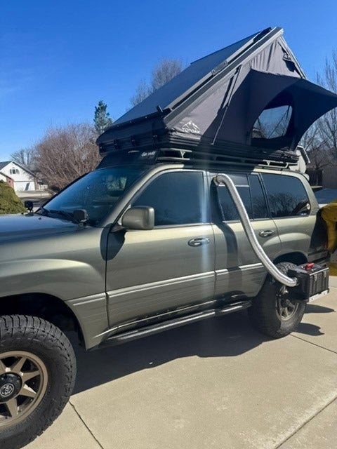

Not the best photo, but I just used some leftover cedar tongue and groove to make a panel to house the controller, vent, and power. Doesn't seal at the window deflector, and the window just sits in the groove. I had these printed to align with the window tracks: Portable Diesel Heater by KeeganBuilds - https://www.thingiverse.com/thing:4271686, and hinged the panel so it stores a bit more compact.
Not airtight by any means, but the 2kW heater is easily able to keep the interior ~40F warmer than the outside despite heat loss from the long hose runs. We usually crack the DS rear window to get a bit of fresh air into circulation and avoid running the heater at the lower settings.
