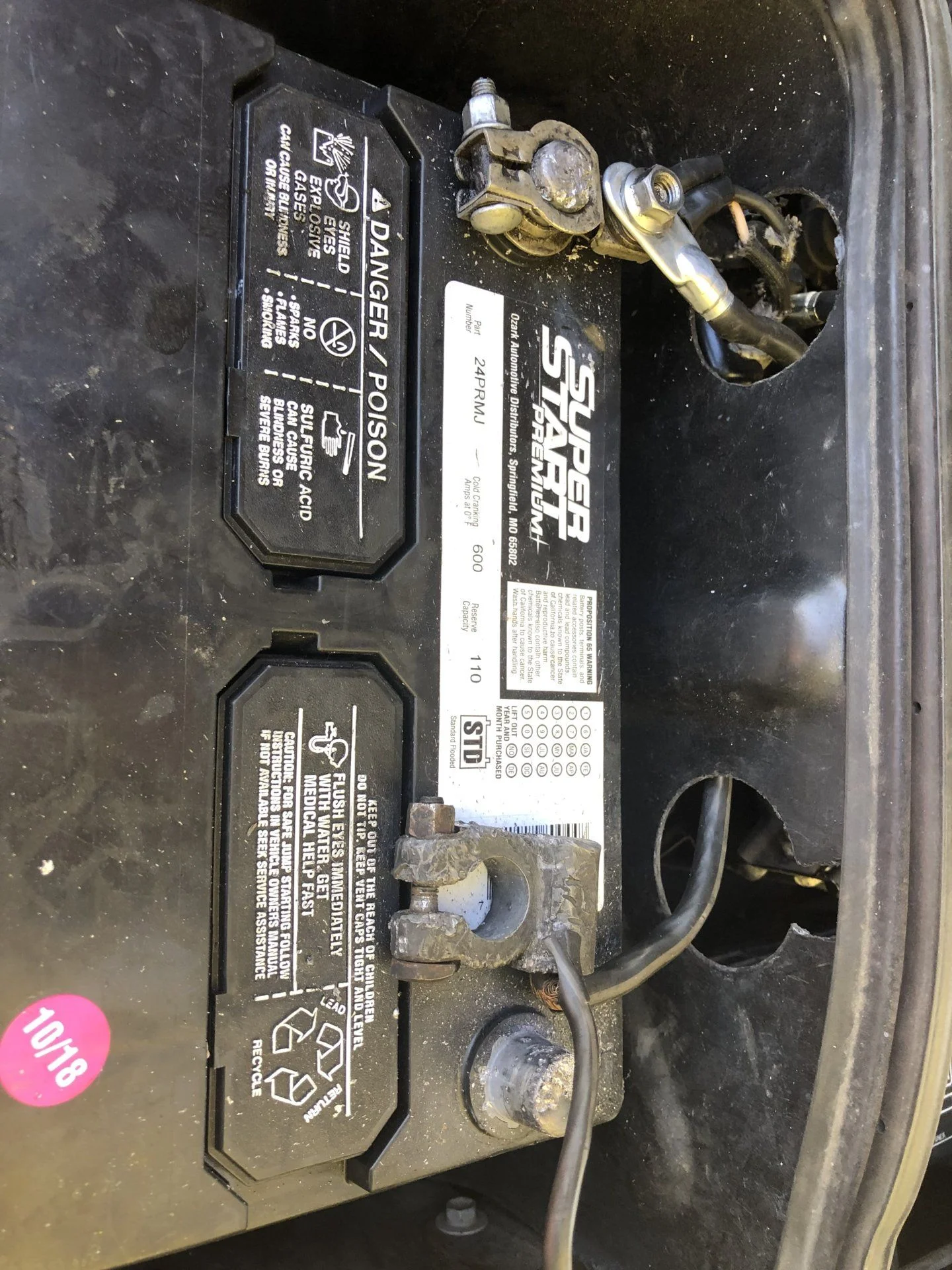

Picture of battery cables/connections would be good. So we can get an idea what the previous owner has done there.
Typically if you have no CEL then the engine will not start (it will crank). Do some searching on this site, lots of writeups on fusible links.
Fusible links are often the issue, there a 3 of them that connect right to the battery positive post along with a thick gauge wire that runs directly to the starter motor.

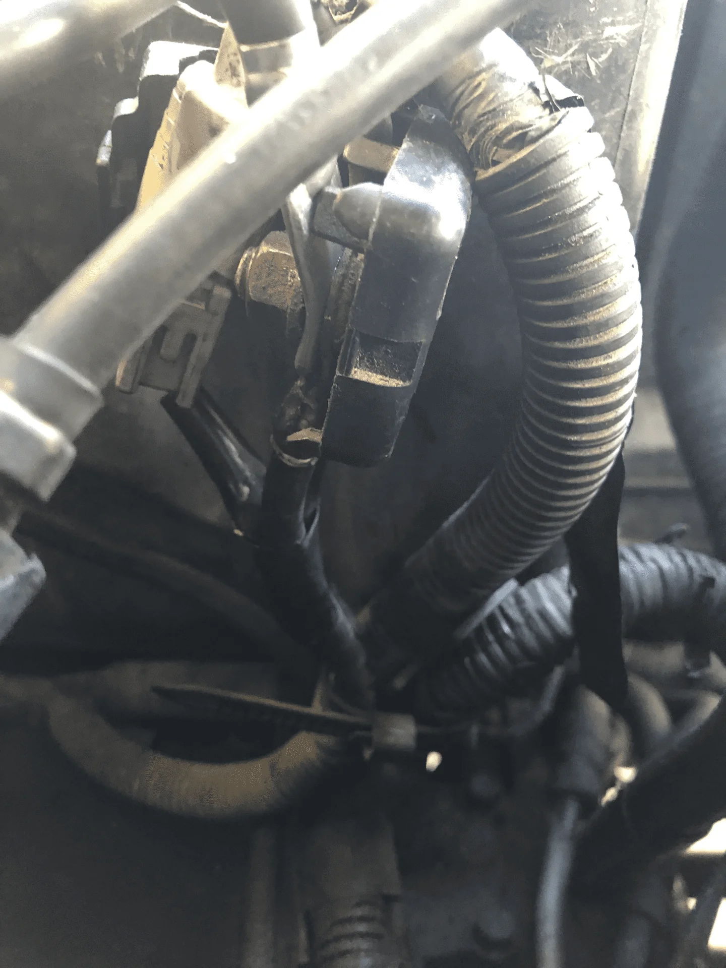

here are three or four pics...
Thanks George! I found a link to order the fusible links...must be the issue. The wire that wore through was one of the three, so this should fix it.
Got a nice tune up in the meantime haha!
And it looks like your current set may not be installed correctly.
