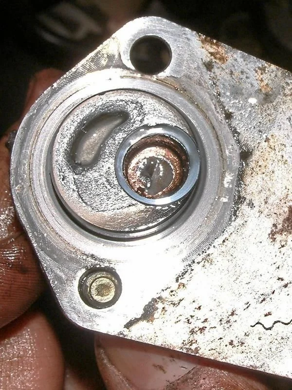

water in fuel/ nope! ACSD Failure!!!
I am now officially the latest member of the broken ACSD club...
As for those who said it was a 5 minute job to remove it... Yeah, right!!!! Two of the Allen screws were unbelievably hard to remove...
I've learned something new today...
1) Don't assume for one bit that the ACSD will 'rattle', letting you know it is about to fail. Mine never made any rattles.
2) Considering they ALL fail at exact same spot, I consider this a manufactring defect from Toyota, and that they must be removed at all costs.
:mad::mad::mad::mad:
