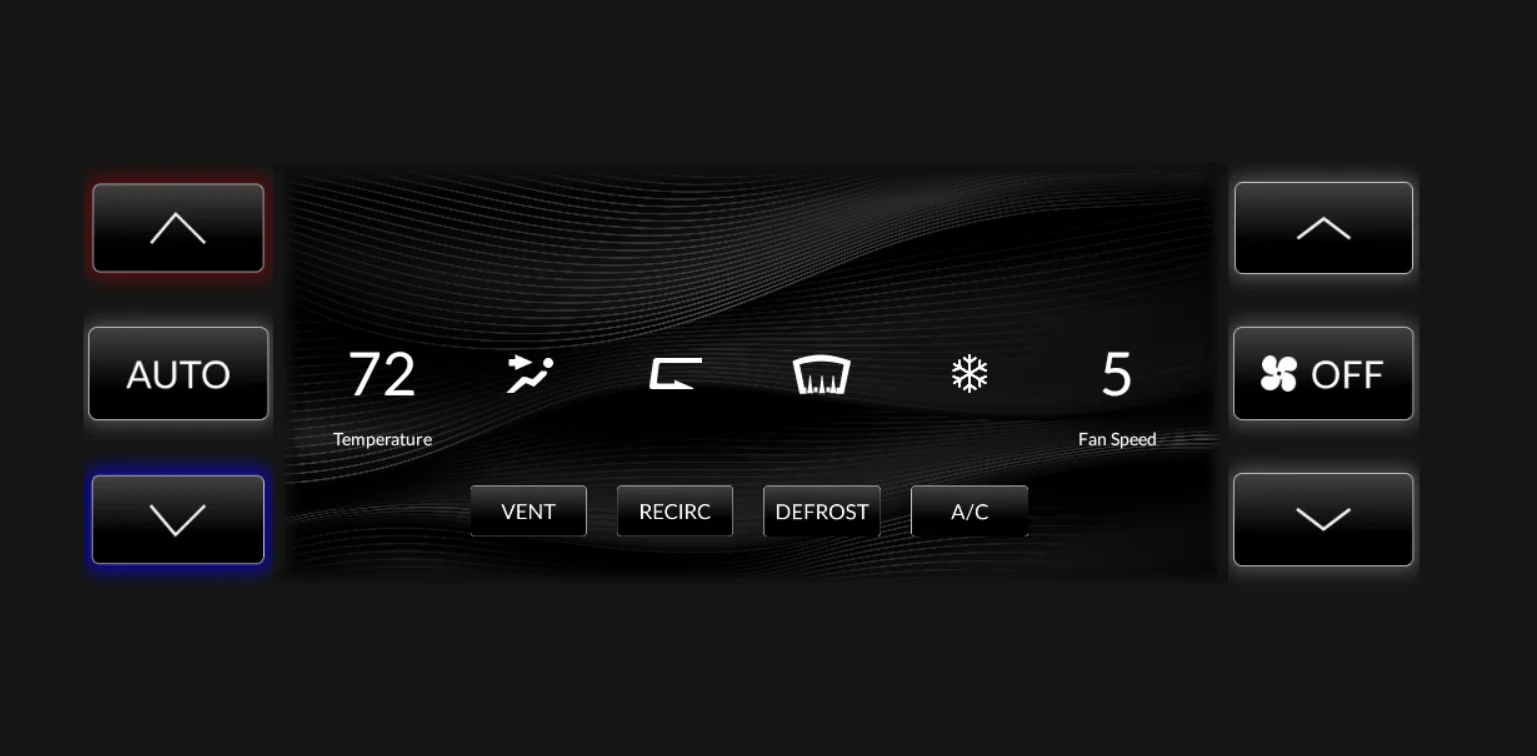

I replaced my Nav with an android screen (teyes cc3) and I want to write an app for the climate control system because the one that comes on the Teyes kind of sucks.

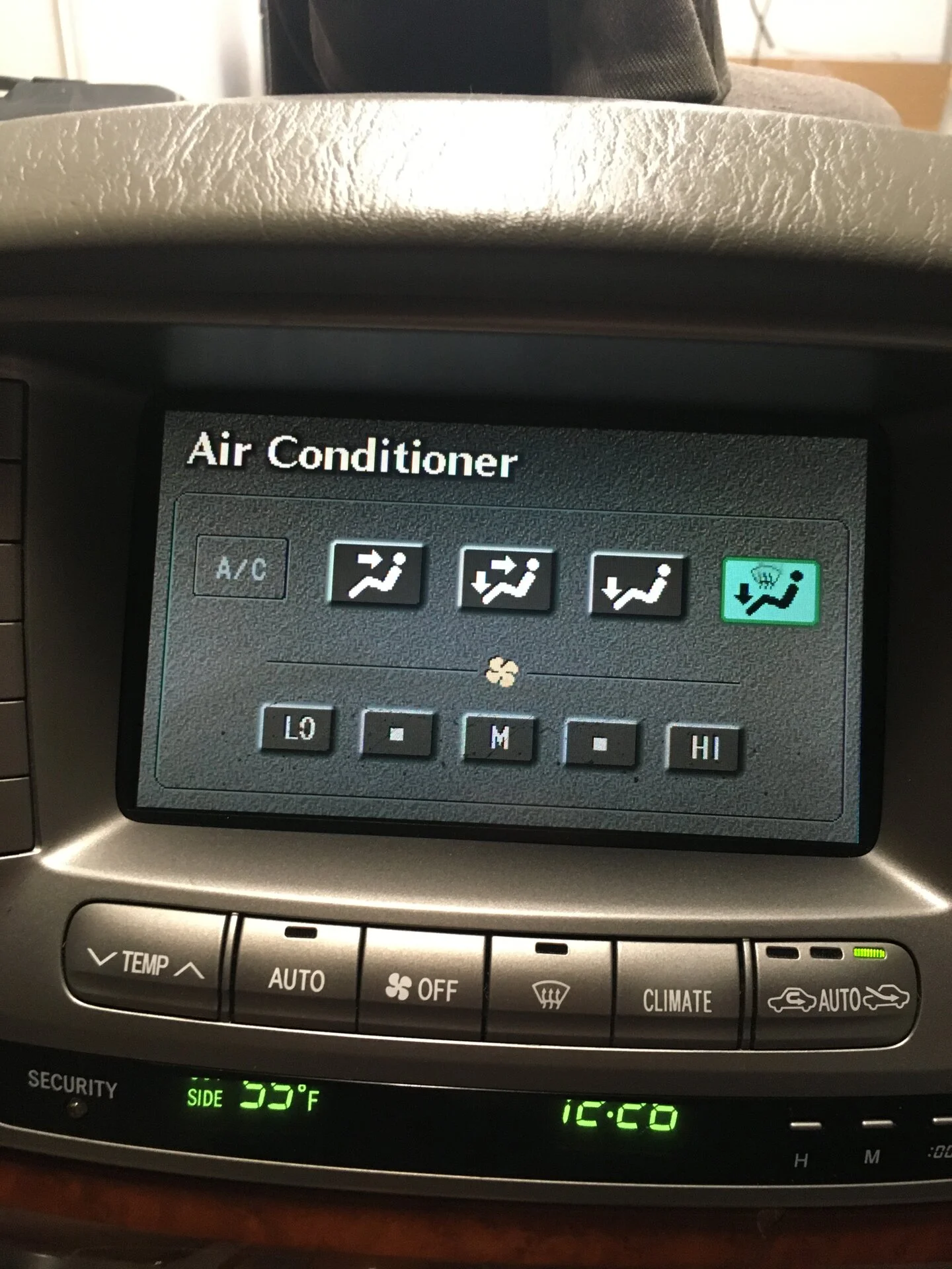

Can someone grab a picture of the climate screen on the stock nav system?
Thanks!
Hope this helps
Here's a quick video showing that it's possible.
On the left is the stock climate screen. It's ugly because it doesn't handle being in split-screen mode very well. The important thing to notice is that the temperature setting is currently at 73 degrees.
On the right is the app I'm building. It's ugly right now but I just want to prove that I can change the climate control settings with my own app. When I tap the "Temp+" button, I'm sending a command to the Climate Control computer over the CANBUS to tell it to increase the temperature. Sure enough, you can see that the stock climate control app sees the truck increase the setting and responds by showing the new temp setting.
From here, it's just wiring up all the other buttons and making it look pretty.
Another quick ask for someone with the stock climate control: Can you put it in Auto mode and turn the temperature all the way down to "LO", then go up one degree on the temperature and let me know what that number is? Then go all the way up to "HI" and down one degree and let me know what that number is?
Basically, I need to know the range of temperatures possible on the display, between HI and LO.
Thanks!

From a 2007 Land Cruiser with auto climate:
LO -> 65ºF
HOT -> 85ºF

Thank you for the temperature range!
I already posted a theory about the noise from the LCs in the main thread, but I don't have one to test on. I think it's a ground problem. I'm sure I could figure it out with a wiring diagram and a truck to test on.

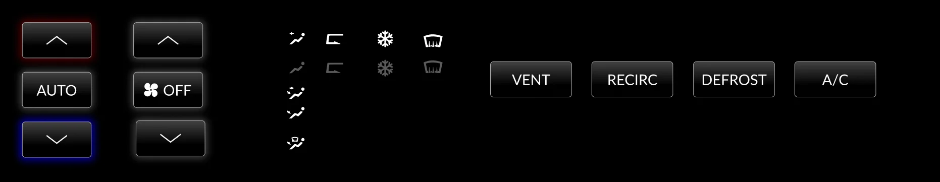

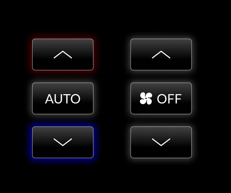

Choosing to use the font from the new 2022 Lexus interface. The closest I can find is Lato, which is maybe a 90% match.
I disagree with them using UPPERCASE for all climate control buttons except "Off" so I'll probably keep them all in CAPS.
Here's an example of some of the buttons I'm creating:
