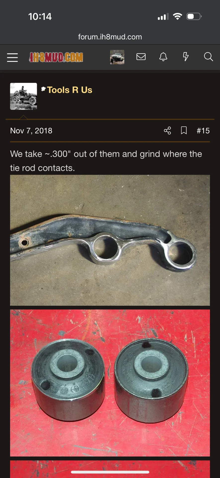

I run the marlin tie rod, land tank castor correction, and ground the radius arms for more clearance. Although mine is ground more than needed. 12+ years of abuse, and was a common mod by Kevin. No need to change the geometry of the steering
What caster correction are you using?
I run the marlin tie rod, land tank castor correction, and ground the radius arms for more clearance. Although mine is ground more than needed. 12+ years of abuse, and was a common mod by Kevin. No need to change the geometry of the steeringView attachment 4214566View attachment 4214567View attachment 4214572
A couple from the forum have mentioned this to me. I am probably going to do this for the time being while I save some Superior Engineering or Delta.
