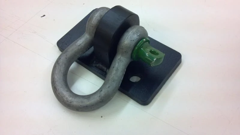

Is this what you are looking for?
i keep hitting the pintle on the ground during ascents. going to pull it along with the bumpers. doesn't anyone make a simple bolt on plate that would accept a shackle in place of the pintle? I sure can't find one.
Pete
That is what I'm looking for and I found one similar to that here in Japan. I want something like that but way beefier. The shackle should fit with little play on a thicker plate with more surface length for the weld. The one in the pic would get bent up pretty quick if used for a good pull at an angle.
Pete
is the pictured attached to a stock bumper?
Check the rear of a '94 era Mitsubishi Montero. I have no idea what this recovery point's load limit is, but the Montero is no small rig. Mounting one of these with a backing plate would help strengthen it.
You can get a $4 bolt on recovery point from any junk yard off a montero. Very similar to the one maxxraven has shown.
