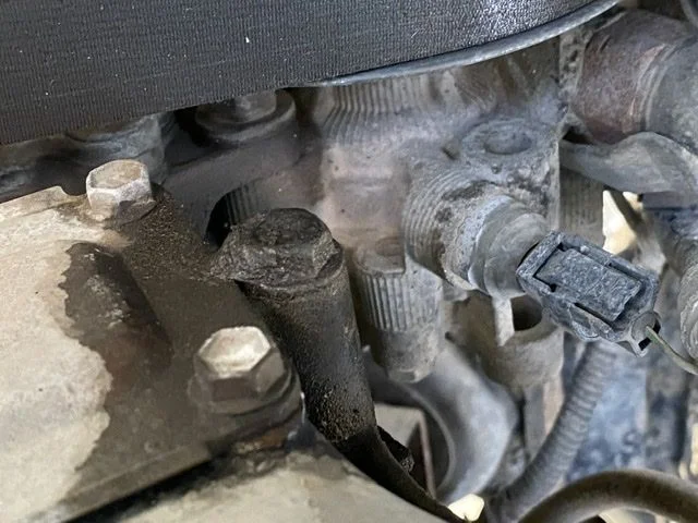

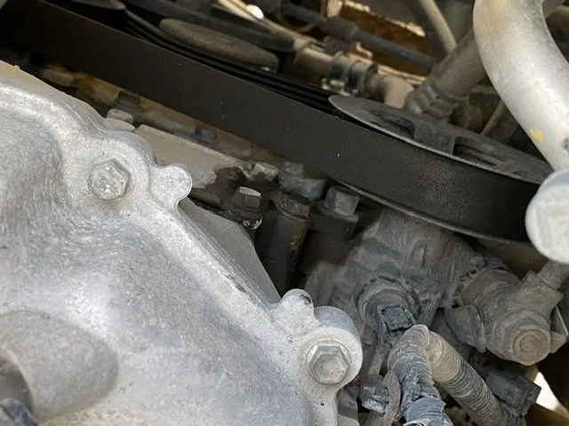

Hey guys, truck looks great over all except for this leak looks like. Is this a serious thing?
It appears to be a timing cover leak. About $2000.00 at a Toyota dealer. :( It is a lot of labor just to get to it.
It is not unheard of on the 1GRE engine. A lot of guys go for years and never have it re-sealed.
The same thing happened to my 2010. Luckily, the dealer was doing an oil change 1 week before the warranty expired and caught it. They covered it under warranty.
This one ha 145k miles on it and is clean with good service history besides this. My kid is the one buying it. You think it will be ok for 4-5 years? I know it’s a loaded question
All I know is .......... there are a lot of guys that leave it alone. If it is not dripping oil on the ground you are "probably" ok.
Typically, it is just a "seep", not really a full blown leak.
My truck never dripped a drop of oil on the ground but being the dealer was going to fix it under warranty it was a no brainer.
Can you take the truck to a Toyota dealer and get their opinion?
Edit: Google "Toyota 1-GRE timing cover oil leak" for more info :)
