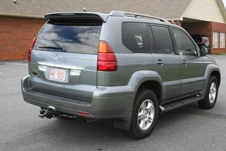

I'm going to go look at a 2004 GX470 this sunday. It has 81k and it looks to be in great shape. Clean carfax. They want 19.9k for it, which seems a bit high to me. What do I need to look for? What kind of MPG should i expect? Any problems with this year GX? I'm selling off my FJ62 and current DD to get this as a wheeler DD. Sorry for all the questions, this is a totally different beast than what i'm used to.
Thank you for all your help.
John
