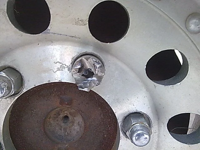

So far this is what I have and the dam thing still hasn't budged :|

I think what i'm gonna do is take the impact air chisel and see if i can wedge it in that space and hit it. Maybe it'll cause it to split
You could try heating it up and use a set of vise grips to try and twist it off. Good luck, we deal with this s*** all the time at the shop and it sucks. Most of the time it is a anti theft lugnut with the key no where to be found. We have a removal kit from snap on but you don't want to spend that much for your one lugnut. Good luck!
They are both off. I hammered on a 24mm socket onto the lug nuts. Had a good grip and unscrewed them.
Then used the airchisel and put the socket between two bricks and slammed the lugnut off the socket.
The nice thing about the HF stuff is you can take it back if you're not satisfied.
