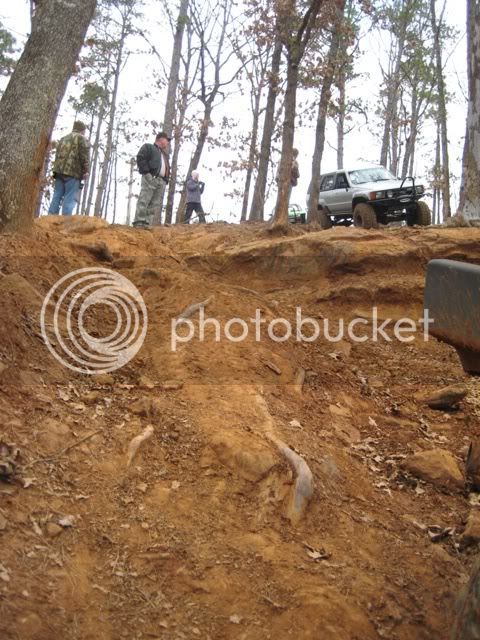

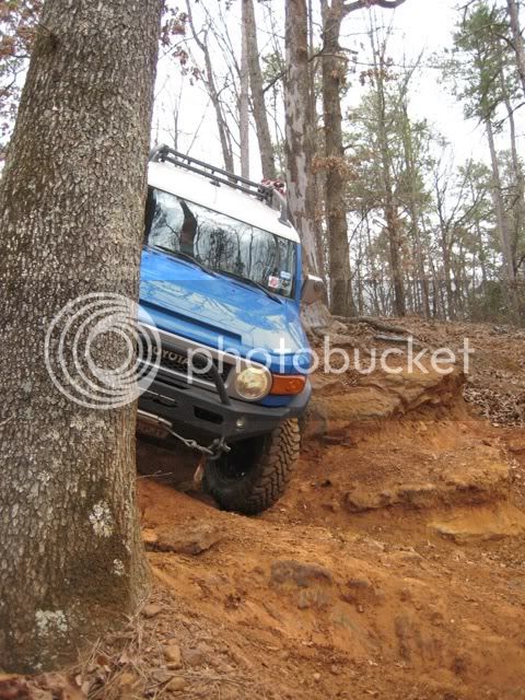

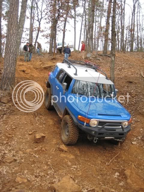

Bringing the thread back 'round to its original topic :), I HIGHLY recommend saving up and getting the ARB front locker at the same time you re-gear for anyone comtemplating re-gearing. Got to use mine in earnest for the first time, wheeling last weekend and WOW I was impressed! Instant on and instant off (unlike the stock rear e-locker). In several situations on 4-rated trails (4 out of 5) at Barnwell Mountain, it was like an Easy Button. I'd have my front wheels on top of a tall ledge and the rear still on the bottom, and didn't have enough traction even with the rear locked. Engaged the front locker and BINGO it pulled right up every time! I wish I had some photos but it I didn't have the time to get out and take any because I with a group. Here are a couple that others took going down, but none up:
Here is a trail-mate (built 1st gen 4Runner) about to descend the obstacle I just did, you can see the corner of my rear bumper on the right side of the photo:
