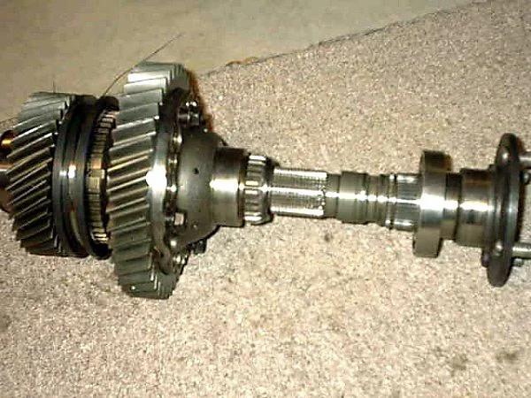

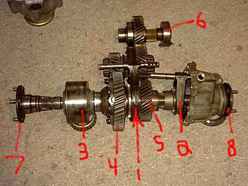

I am a bit rusty on this so correct me if I am wrong.
1) low high selector
2) diff lock selector
3) VC
4) low gear
5) hi gear
6) input from tranny
7) rear out put
8) front out out
4, 1, 5 is the center diff.
If you have lockouts you need to lock the diff #2 other wise the VC #3 need to spin/slip till it locks up. This is the sloping feeling you are feeling.
Just guessing here but if you removed the VC and welded the rear out put shaft to the center diff or weld VC together you would have power to the rear wheels all the time and the front out put would not turn till you lock the diff lock??? Wouldn't this be a true part time t-case now? I am sure this has been gone over in the past, I have no intention to do this mod and will not search the subject.
The second is a pic with out the VC.
Great pics!!!
#4 is the CTR differential as well.
