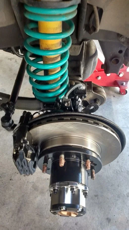

Here is a picture of what is happening to the springs. They're even worse now. This was taken last winter when I did a front axle/brake/hub rebuild. Since then I also added 30mm poly spacers. Also, I thought maybe I had too much caster correction (3 degrees), so swapped out my bushings for different ones (2 degrees), but it made no difference to the springs.

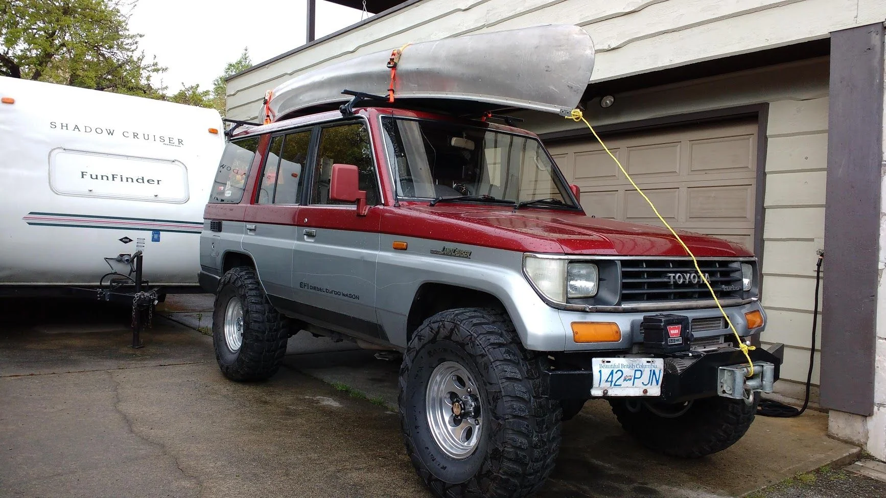

This picture is from a few months ago, but the truck front has sagged worse since then. Also, the back is heavily loaded in this picture, so is sitting lower than normal.
