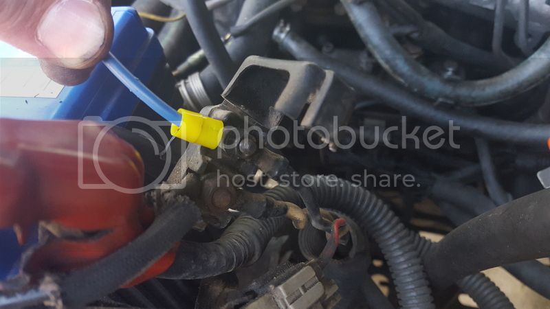

Ok so I swapped out my injectors today and decided it would be a good idea to test my glow plugs at the same time. Did all that, buttoned it all up and now the truck won't start. When I first turned the key on I fried a wire...
I replaced the burnt wire with the blue wire in the picture.. anyone know what it's for?
It is a thick black wire that seems to run into the firewall with what looks like the main harness. It is junctioned as you can see to the blue wire and hooked to the positive battery.
Does this even make sense?
So you replaced a burnt wire with the blue one which connects to the battery...
If that is correct the wire you replaced is no ordinary wire but what is called a fusible link.
Its a simple fuse.
Before you turn anything on I would be checking all your connections again as something big has shorted out.
You may have earthed out the glow rail....
And you will need to replace the new blue wire with a proper fusible link / wire as it will not blow at the correct current draw and will burn other wires in the system which are smaller.

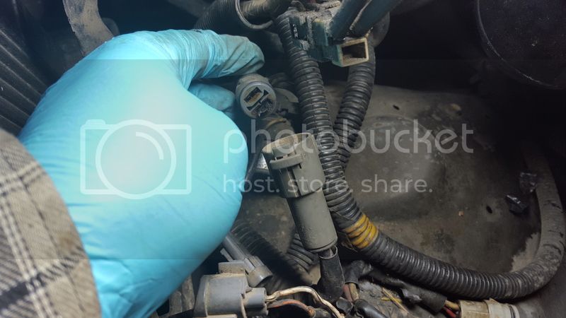

Found the problem!
Got it up and running again. Kinda jerry rigged it for now. I have to find new ends for this plug.
Nice work. I better check that connector on mine. Could be half burnt too.
