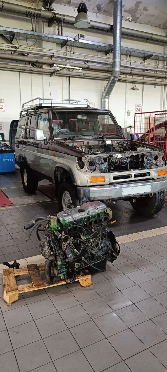

Finally i did it. It runs, it crawls, it does everything i need it to do very well. Engine itself fits pretty snug in lj78's bay. I will try to answer any questions you may come up with regarding this swap in this thread.
