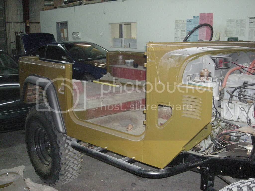

Right now with the body completely off the frame I'm having my 79 BJ-43 done in Line-X on BOTH the underside exterior and the inside on the floor and wheel wells. I will post pics soon.
LineX Pics
Here are some pics

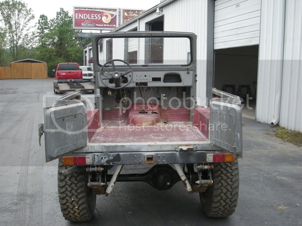

pics: Befor I get the LineX
You are going to want to shoot the gas tank cover and tranny hump cover out of the rig or apply thin tape to the seams or you will play hell removing them after you shoot it.
