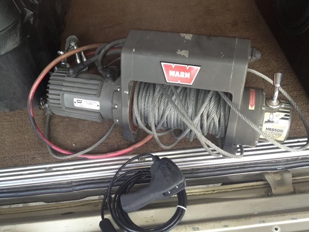

Pics of the winch I picked up today....
so....
Today I bought a car hauler and the winch came with the deal, but wasn't installed.
I sold the trailer without the winch today for more than I paid with the winch.
All this equals = AWESOMENESS.
I made $150 for my trouble and now I have a good working winch that I can clean up and throw some good Synthetic line on.
The steel cable on it now looks great, but there is no fairlead and the hook is a chinese High Test..... The SUCK!
Going to go with some 3/8 Amsteel blue from Southern Overland.
Here is a quick pic of the winch as it sits in the back of my wagon:
