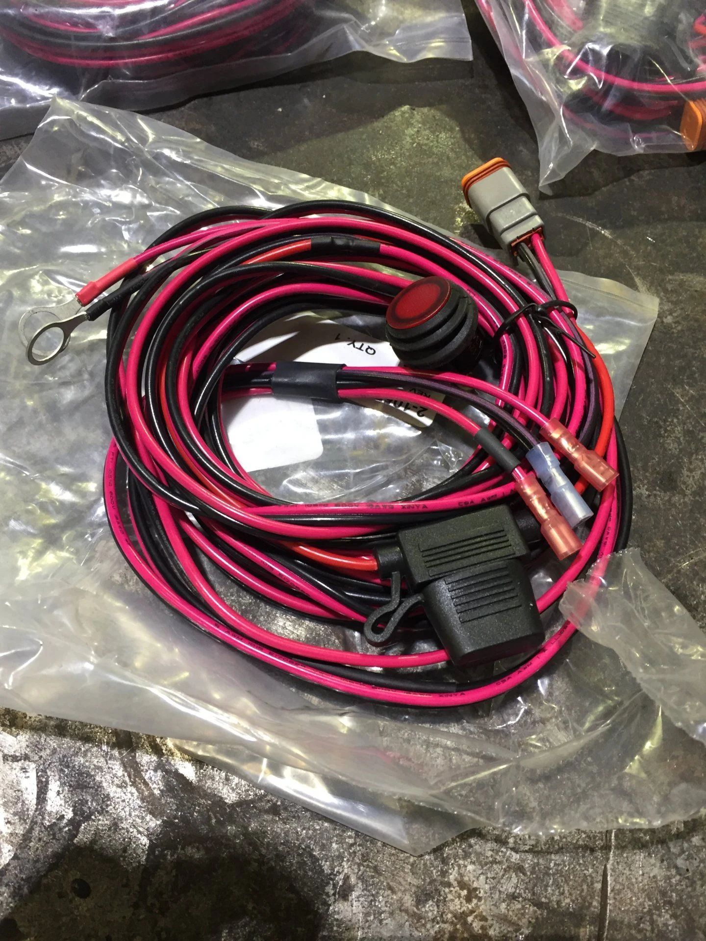

Pretty much what everyone else said, you'll be fine! If you need harnesses let me know, I've got a few that i'm getting rid of from "Rigid LED" lights.
