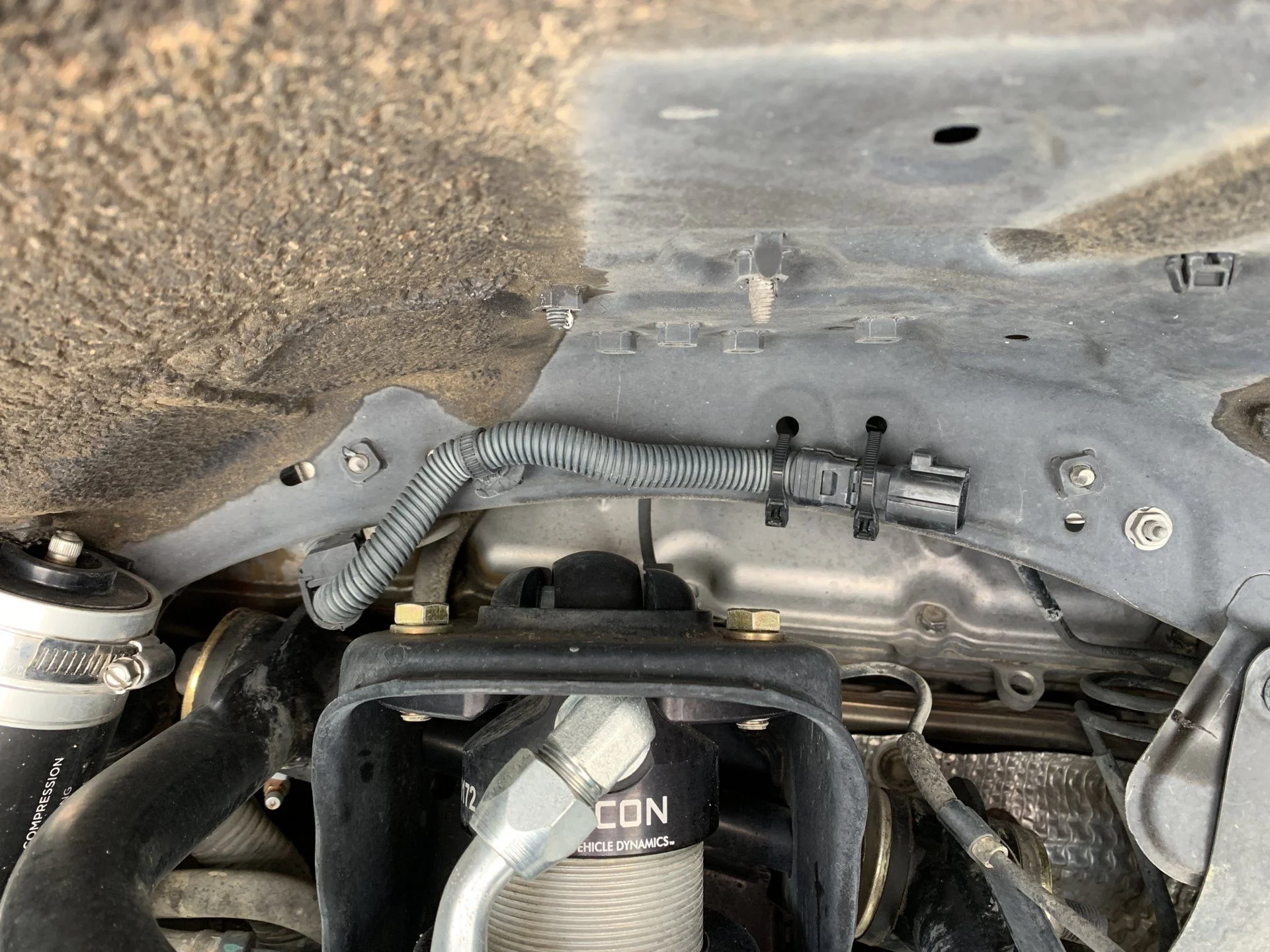

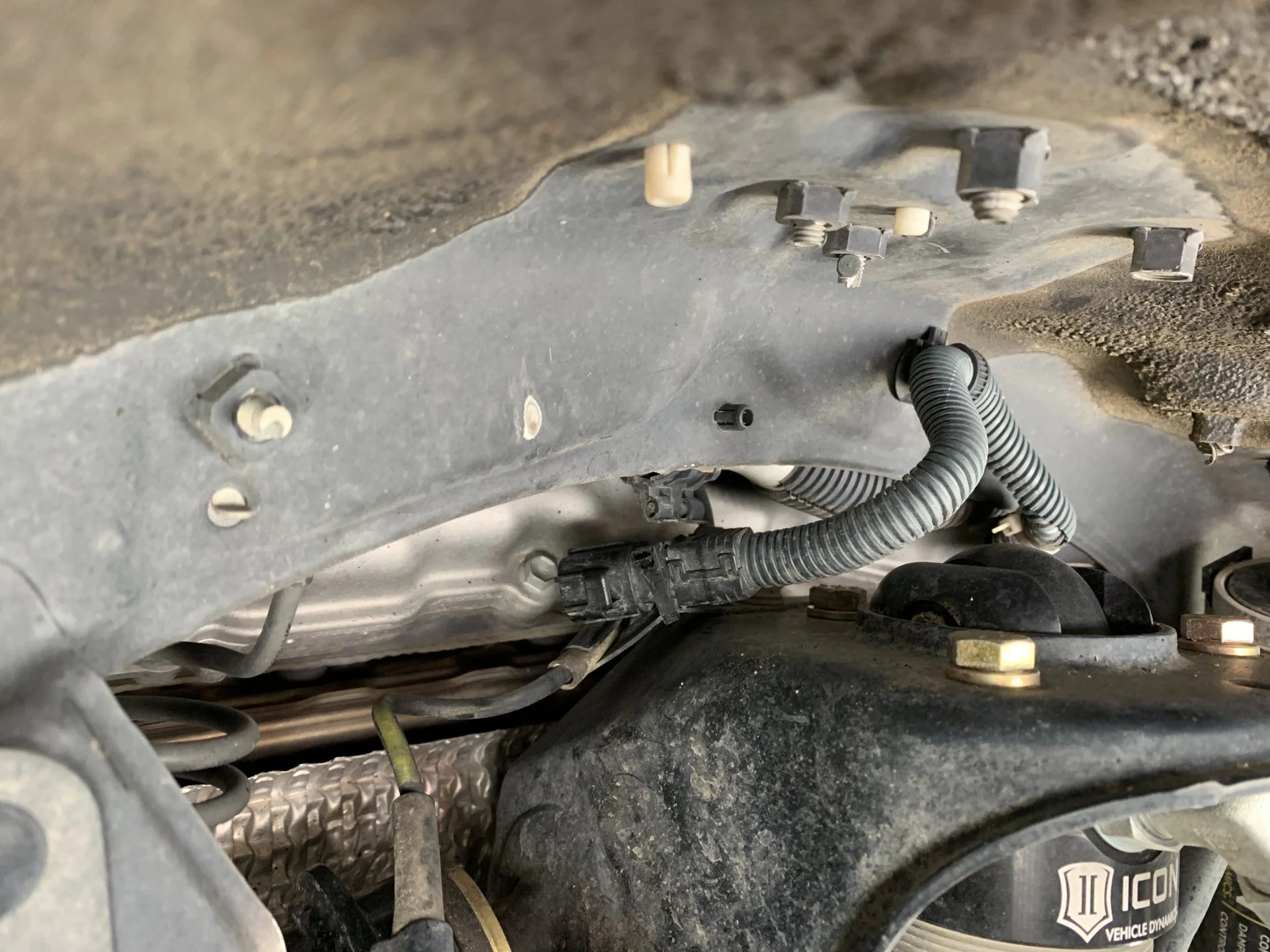

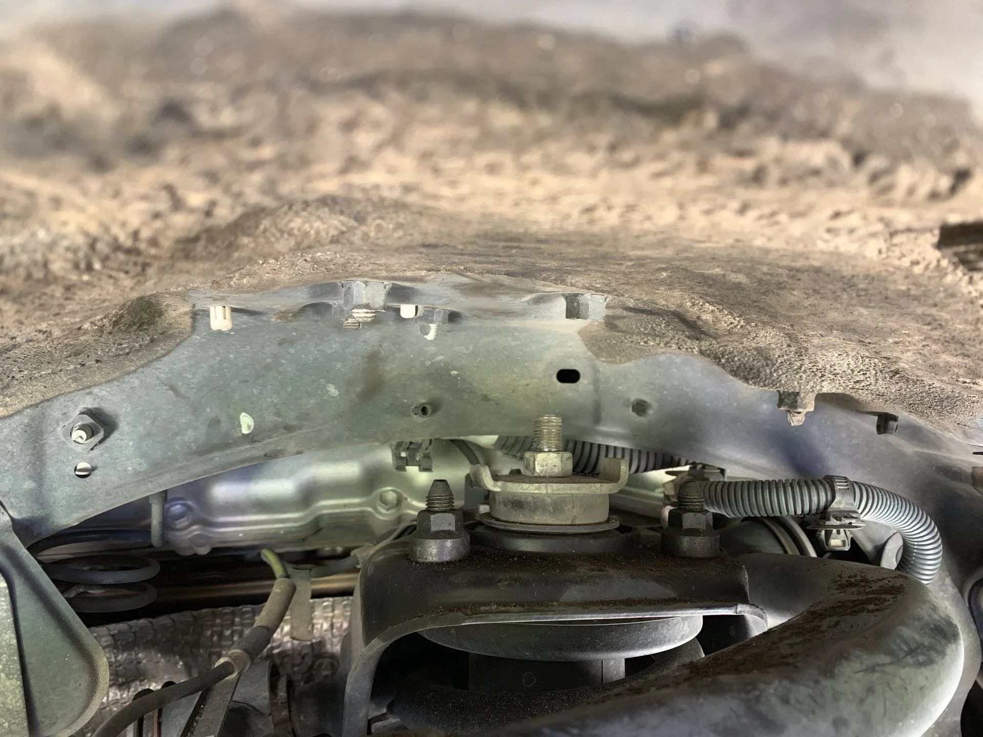

Just unplug the shock modules and leave them out. No error lights on my truck after doing that.
Driver's Side
Passenger's Side
Hard to see, but on the passenger side I zip tied the plug to a tab that holds the ABS line. You can see it if you zoom in on the image.

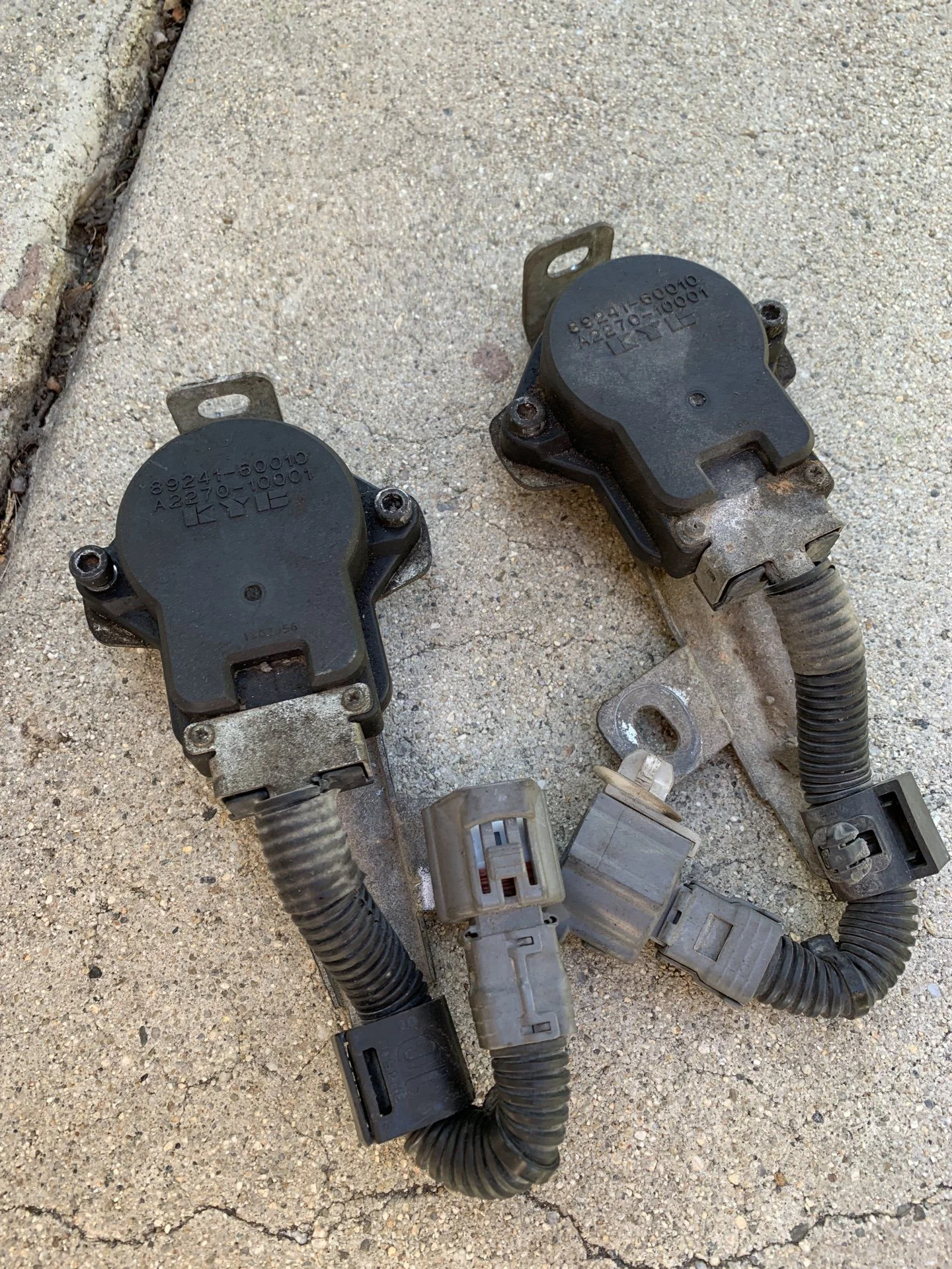

how do you remove the module and bracket above the shocks.
It was a pain to be honest.. probably the hardest part of the install was removing those stupid controllers. Well.. it’s a toss up between the shock controllers and the front KDSS sway bar reinstall.
There are two Allen bolts on the top of the module. Remove those and it should lift straight up off the shock.
On my truck both the the Allen bolts were frozen on both sides. I even used PB blaster and let it soak, but I ended up stripping 3 of the 4 bolts.
I was able to remove two of the three (the ones towards the outside of the truck) with vice grip pliers. Very slow going.
For the other side that this didn’t work I was able to rotate the module enough to loosen the nut that sits between the module and the metal bracket, then I just used a long Allen key to unscrew that nut by just pushing it with the Allen key, 1/6th of a turn at a time. Eventually it came unscrewed and I was able to pull the module and the bracket off together.
Hope the description makes sense.
The bracket is attached to the threaded part in the center, this the the nit that I needed to remove with the module in place.
This is the top of the modules. You’re supposed to be able to remove both of the Allen bolts, pull the module out, then unscrew the nut that holds the metal bracket in place.
