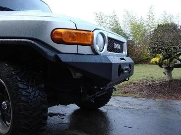

I just installed the Expedition One front bumper. The wheel flares were measured at 35" before intall and after install measure 34 7/8".
I have not attached the winch yet as I am still deciding on which one to get.
Stock bumper = 35 lbs (includes crossbar, nuts and bolts)
Expedition One fb = 120 lbs (includes weight of everything shipped)
Difference is 85 lbs of added weight between new bumper and stock bumper.
