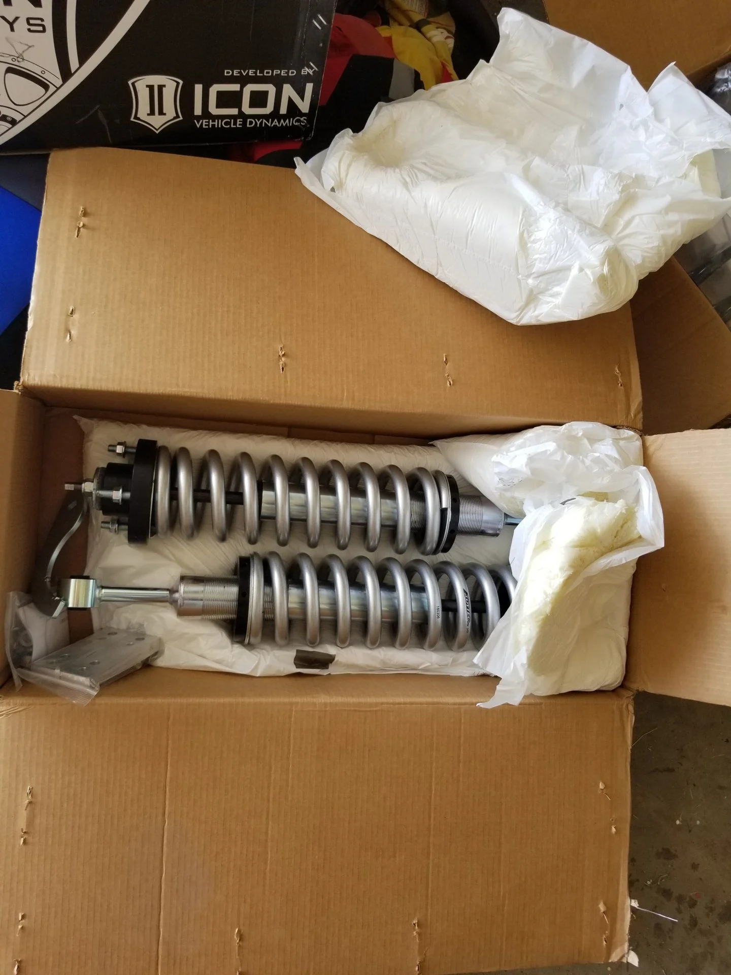

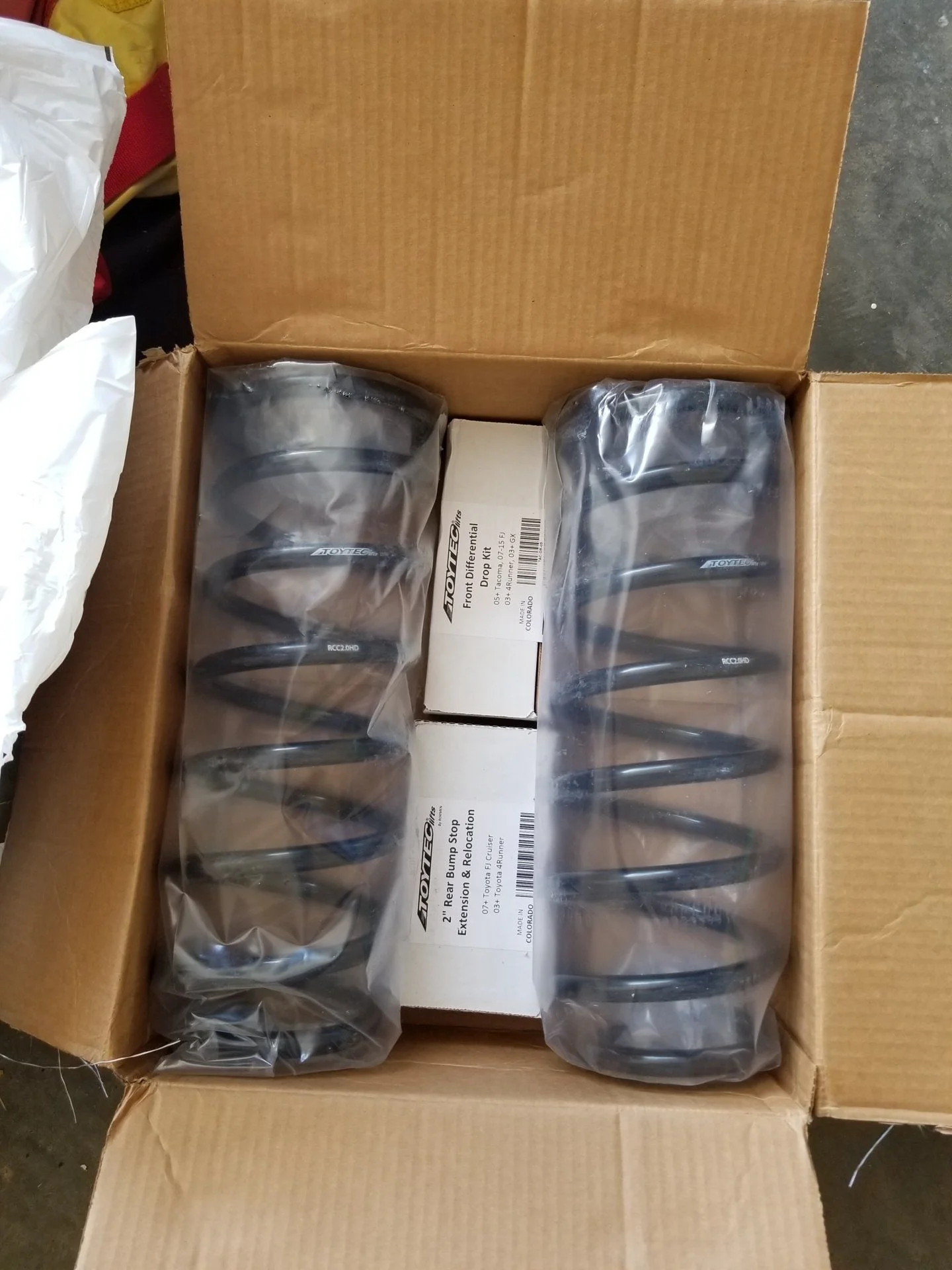

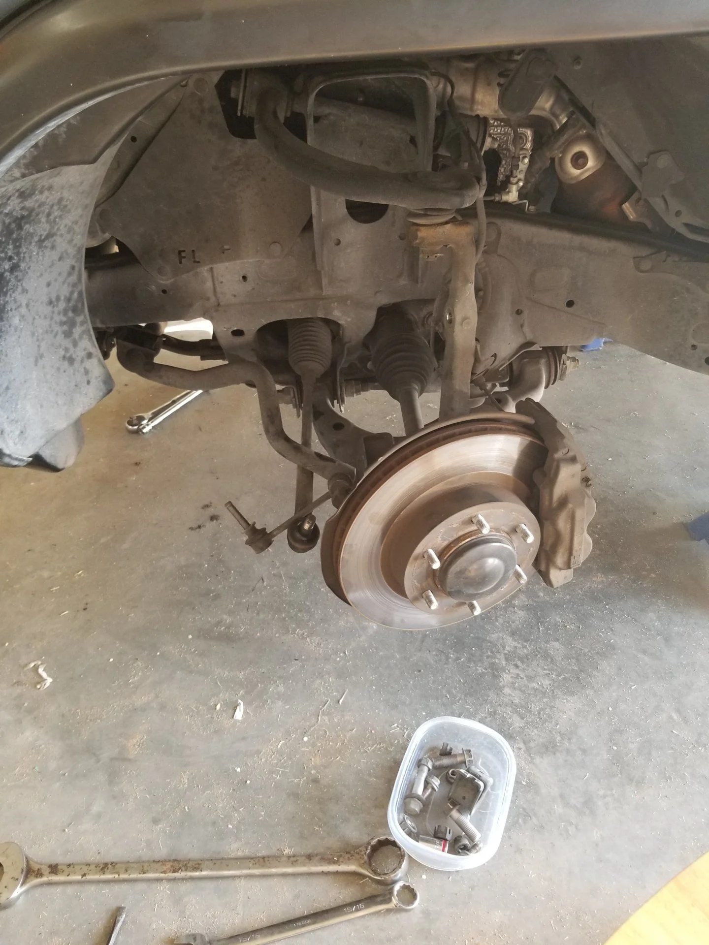

I'll post up pics once I install it
Parts are starting to come in. Just waiting on the rear shocks .

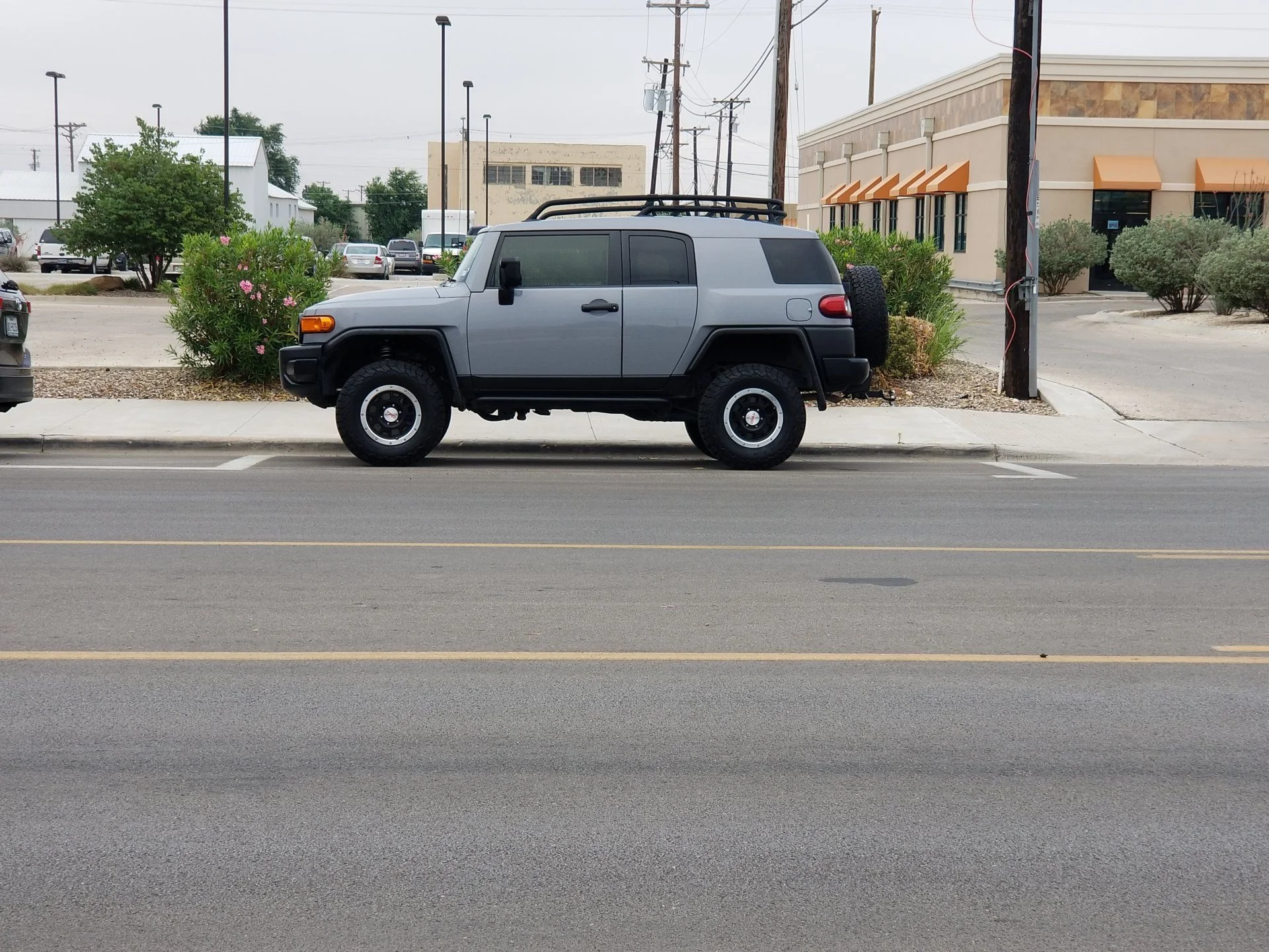

Finished. I was worried that the lift would make the tires look too small but I think it looks ok. I will probably add some meatier tires when these wear out.
I have to say the ride is amazing with the new set up. Now I need to decide on new tire size. Leaning toward 295/75 r16 but concerned about rubbing on the upper control arm. If they rub I may need 1 inch spacers and frame chop. What is everyone else running with the 3 inch lift
