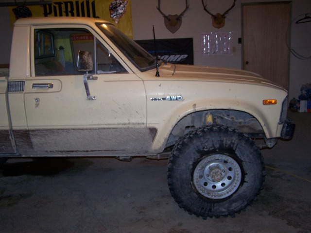

I ran 9.50 x 34 swampers on my old 79 with a add a leaf in the front and dog leg shackles in the rear I did fold the pinch weld on the rear of the front fender wells. The tires barely rubbed when fully stuffed on a tight turn. On the 83 I'm building now, I am going to run a 3 inch lift in the front and add a leeves in the rear, with Q-78 Swampers.
I had a 80 model that I ran 12.50 x 33 Swampers on with no lift. One thing I can say for the 1st Gens, is you can run a pretty good size tire with minumal lift.

I have the 34" swampers on my '80 right now with no lift and they barely rub at all. Only a little bit on the passenger side. That being said, if I had the money right now I would take advantage of Jim's great deal on some 3" springs and get some bilstiens in the appropriate length.
