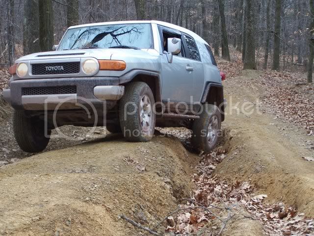

I got it instaled this weekend and everything is working great . It took me about 5 1/2 hours to do it and i was working alone . The spacer gave me 1 inch lift in the front and drops to 3/4 inch lift at the bottom of the frame rail under the door. Measurments at the wheel wells ( driver side ) I had a 1 3/4 inch difference between the front and rear , after the install i have a 3/4 inch difference. I lost some of the body roll when going into corners and it's a litlte stiffer than stock , feels much better . I'm glad i did not go with a larger spacer as i feel it would of put to much preload on the stock springs and i wanted to keep some of the forward lean for visibility purposes. I'm very happy with the new look Yoda has ( the cutteness factor is gone ) and it will keep me satisfied until i have the money for new coil overs. Next step is new rims and tires , looking at the Dick Cepek Fun Country II in 285/75r16 . From my measurments it should fit with out trimming the body mounts. It's been raining here and my wife has been driving the fj to work ( as i'm installing a new top on the mustang ) so i'll get some after photos as soon as i can . For 60 bucks you can't go wrong and it can be installed by a newbie ( such as myself ) as long as you have some mechanical no how . I would recomend having a second pair of hands as the lower control arm was a bitch while trying to get the coil over back in .

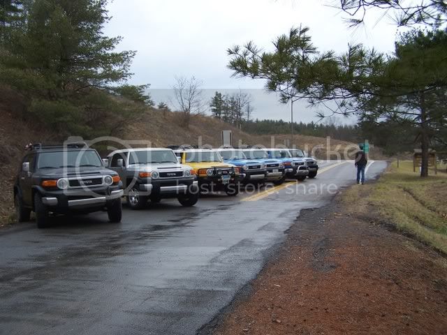

Here's a few pics after the Toytec top spacer was installed.
