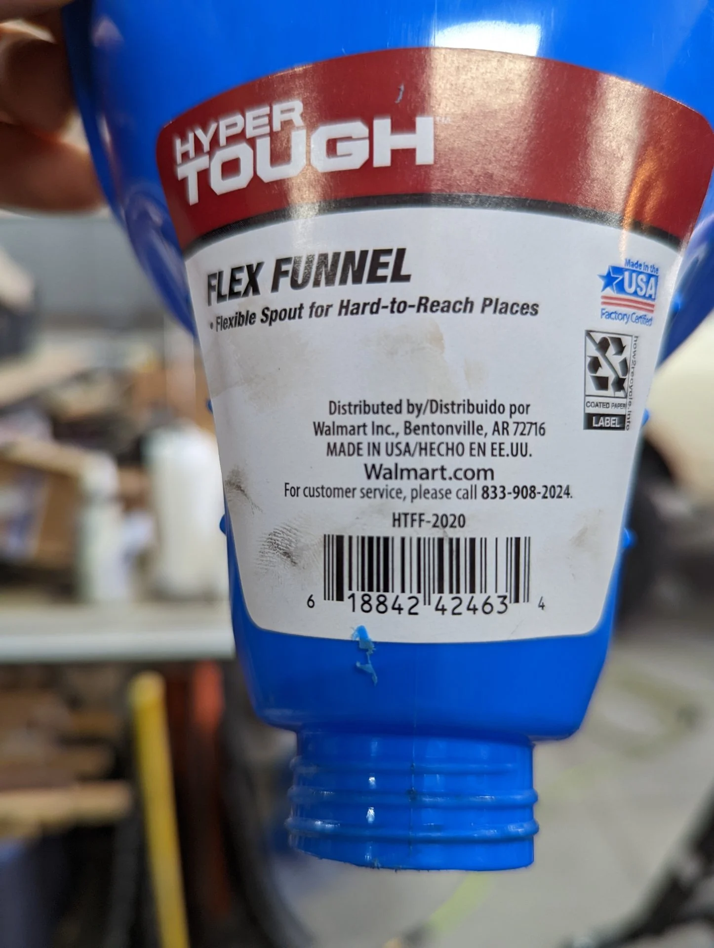

This funnel, and possibly others like it with detachable necks, when modified by cutting off the lower part of the neck with a razor knife, like this:

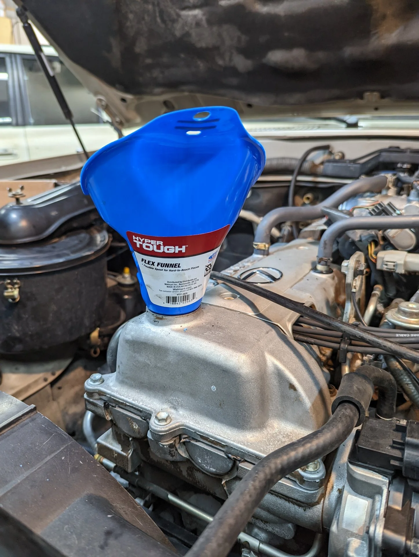

can do this:
I believe the oil fill threads are common to most or all Toyota/Lexus/Scion vehicles, so this should work on all of them as long as the typical engine tupperware doesn't interfere. So feel free to share this with all your Mud tech forum pals.

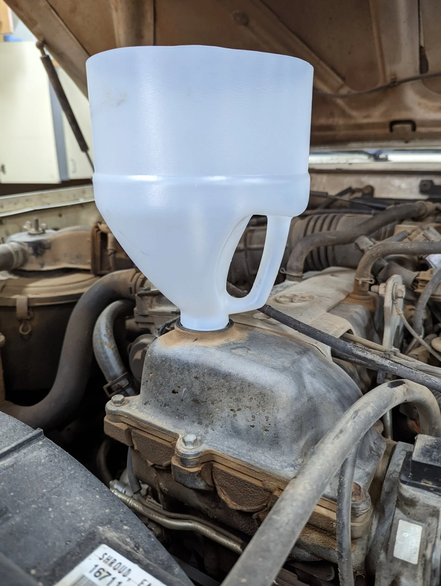

Also, if you're really a cheap-ass, you can modify one of these bottles to do the same thing, with the added advantage of a cap you can use to prevent drips during storage, if you don't feel like cleaning it. Thusly:
That one doesn't play nice with Lexus IS350 engine cover tupperware, which is why I spent the $3 to upgrade.
