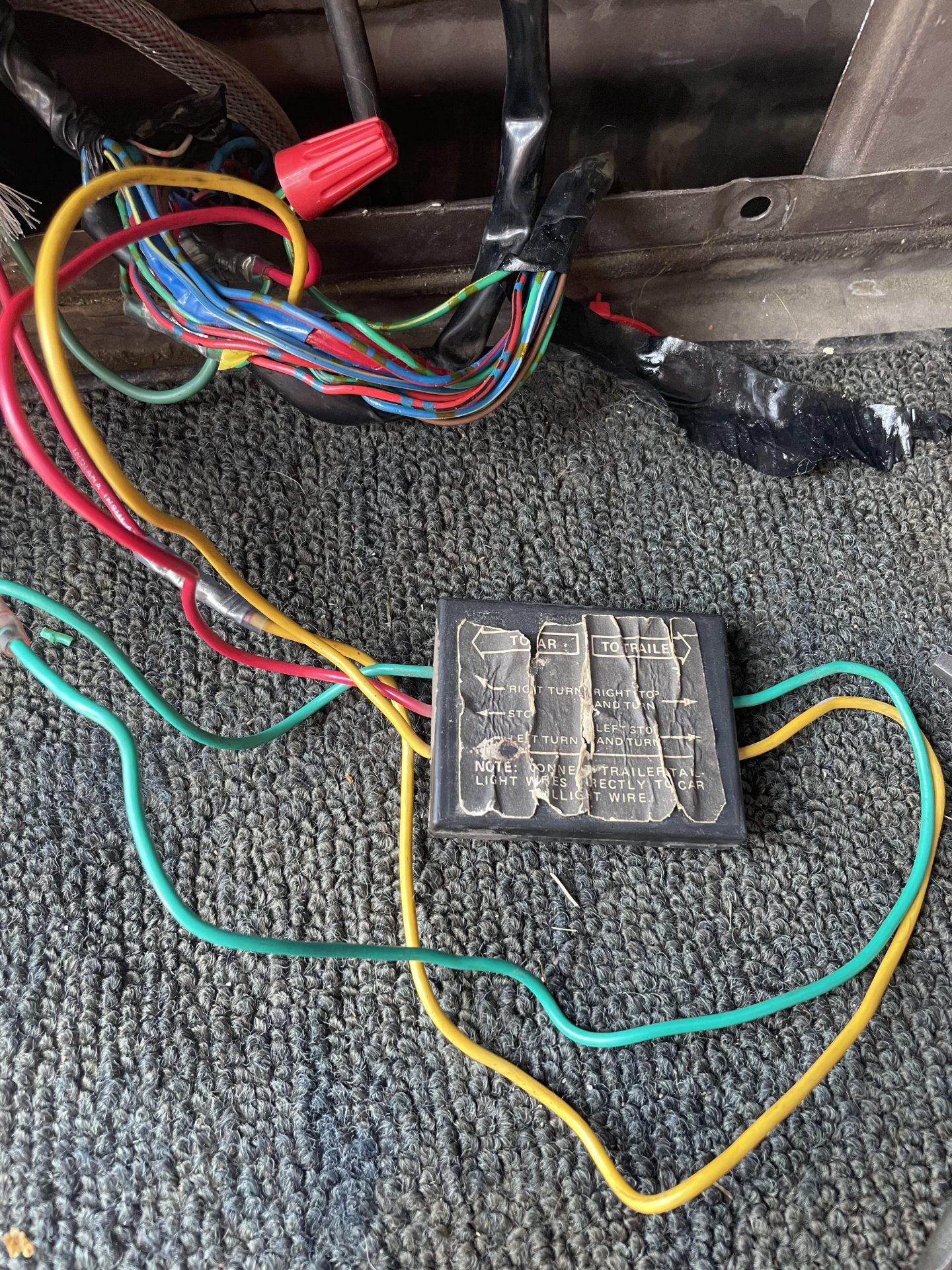

First off, thank you to @Gretsch for this valuable info. To keep the gremlin hunt story short, it was indeed the connector for the trailer hitch, though it certainly looked "official" upon initial review. After examining all the wiring that I was willing to dig out, I finally cut out the connector for the right turn signal from the trailer wiring box and reconnected the original wire. Signal works great with no brake light flashing. Brake lights and left turn signal still running through the trailer box and are working fine.
So...my next question...what should I replace the box (pictured below) with? Though I have no immediate need for trailer lighting, would love to have it functional.
Thanks again!
Thanks again!
And thank you to @poptart !
Thanks again!
So I happen to know that a top notch mud vendor is working on a plug and play trailer wiring kit that includes everything you need to get trailer lights working. In the final stages of development and will allow you to have trailer wiring with a nice 7-way plug without all the wire cutting typically needed to do this. The kit will have factory type taillight plugs that allow you to separate the factory taillight plug and insert a factory type plug that splices into the factory harness to get signals needed for the converter box. The kit includes the converter box, the connectors, the wire loom, the 7-way trailer plug, everything. All the grounds are run straight back to the battery post, so no body grounds to troubleshoot. Its completely plug and play. If you can hold out for that kit, I would highly recommend doing so. Some deets here:
