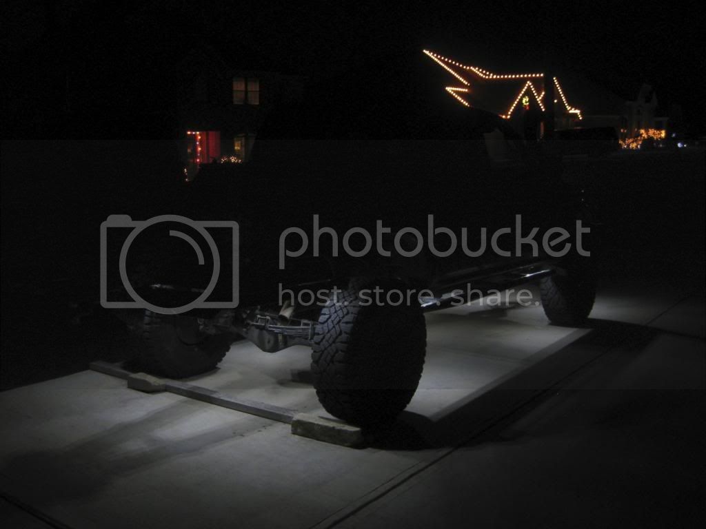

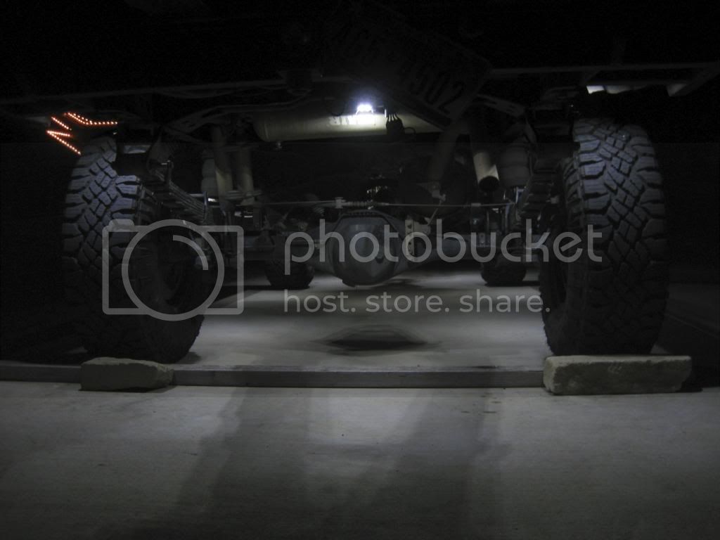

Well the past few months, I been collecting, building and finally mounting a few rock lights to my Tacoma.
LIGHTS ON!!!
Rear View
Angled View
These are slightly darker than in person.
Other than that, they all work and seem bright enough.
I still have left over lights and I still have to hook up the hood light I want to mount.

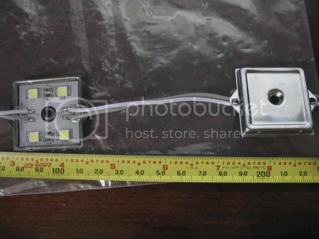

Info on the LED lights....make sure if you order them, it uses VDC....
Distance between each LED square is 3-inches.
THe LED Square are 1.5 inches
Cost @ $22 + shipping.
The wire gauge used is 20 awg. between each module.
http://www.ebay.com/itm/20x-SMD-Mod...227?pt=LH_DefaultDomain_0&hash=item1e66c7e51b
20x SMD Module 5050 4-LED Waterproof White Light Lamp 12V
IP-65 grade
Description:
20pcs of SMD 5050 4-LED modules connected in parallel circuit
Waterproof construction
Low power consumption, high energy efficient
Luminous: 15LM
Viewing Angle: 120 degrees
Grade of Waterproof: IP65
Emitting Color: White
Operation Voltage: 12V
Current: 0.12A
Grey wire for anode. white wire for cathode
Power Consumption: 1.44W per module
Overall Length: Approx. 7.7 ft / 2.4 meter
Single Module Size (L x W): Approx. 1.4 x 1.4 inch / 3.5 x 3.5 cm
