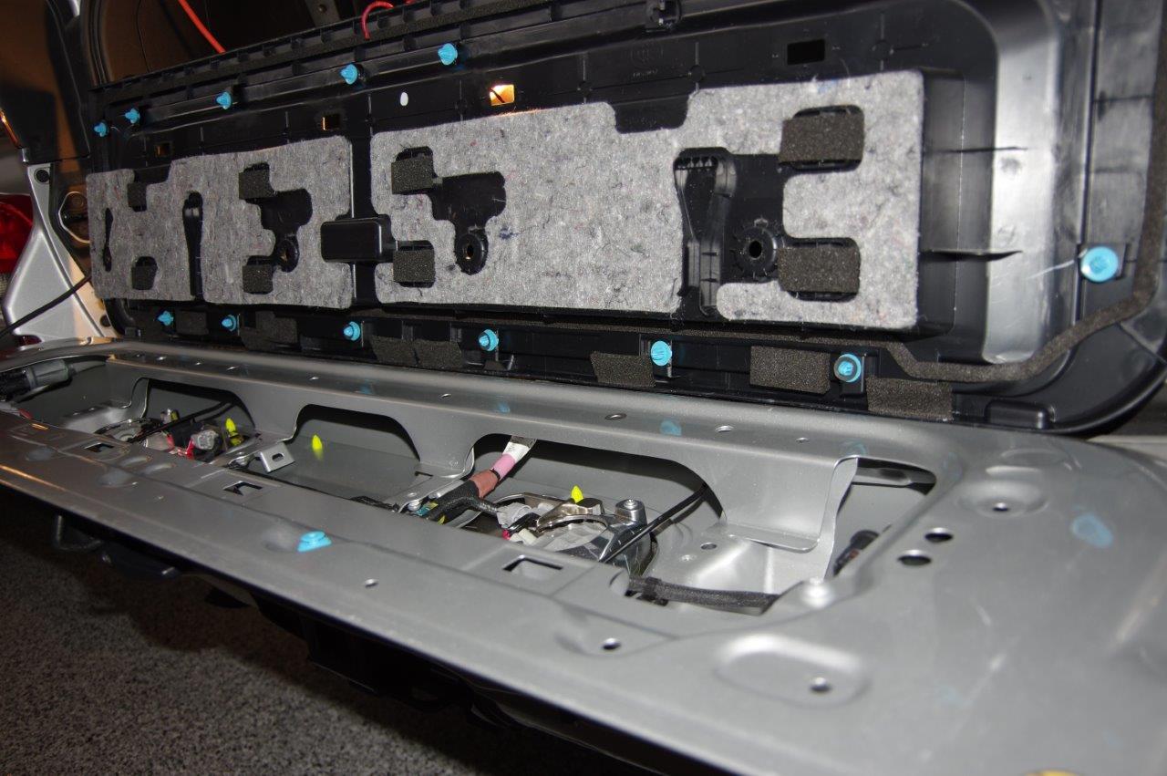

This was a super easy job, but since it involved pulling unseen clips, I decided to post some pics for future reference. Note I show where I started prying with the red trim tools at the hinge side and then the latch side. Expect some loud popping as you pull those clips out! The clips are light blue and did not break, though one detached from the tray when I removed it. The bulbs inserted smoothly and polarity didn't matter. Everything snapped together tightly.
