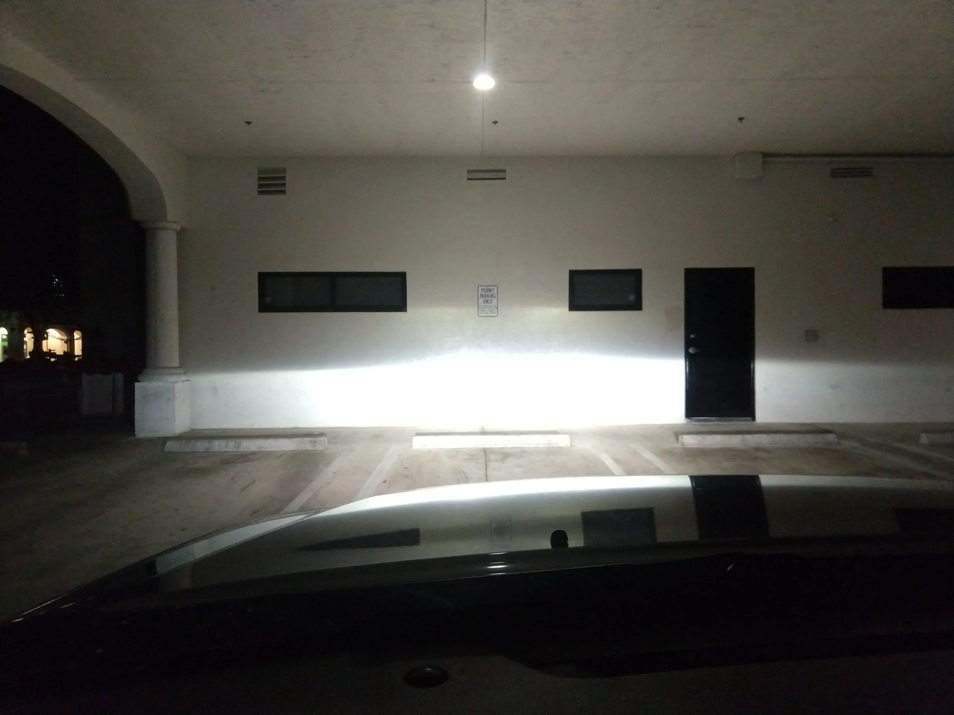

Well it isn't as bad in a projector housing because it has a cutoff that will minimize glare. The stock headlight projectors however have a tab that produces a glare that needs to be bent out of the way and coated with some dull paint to eliminate that glare. The aftermarket depot lights don't have this tab so it's a non issue in those. You can see it here, there is still lots of glare above the cutoff where there should be none so it's up to you but be assured it will bother some drivers.
Thanks are those Xenon depot bulbs, low beam I presume. That photo is the best understanding of what many have been describing on the forums now I can actually see what they are talking about, but at the same time those lights do look better than the stock halogens the glare seems like it would be minimal but maybe not for oncoming traffic.
In the picture it looks minimal because of how close to the wall it is. At 25' it will look even worse although it should at that point start to drop down a couple inches if the headlights are aimed properly but the tab on the projector unless modified shoots light up so that still will cause enough glare to make one reconsider.

I'll throw a pic in for fun. Not that headlight pictures are all that useful... The slight glare is visible on mine as well.

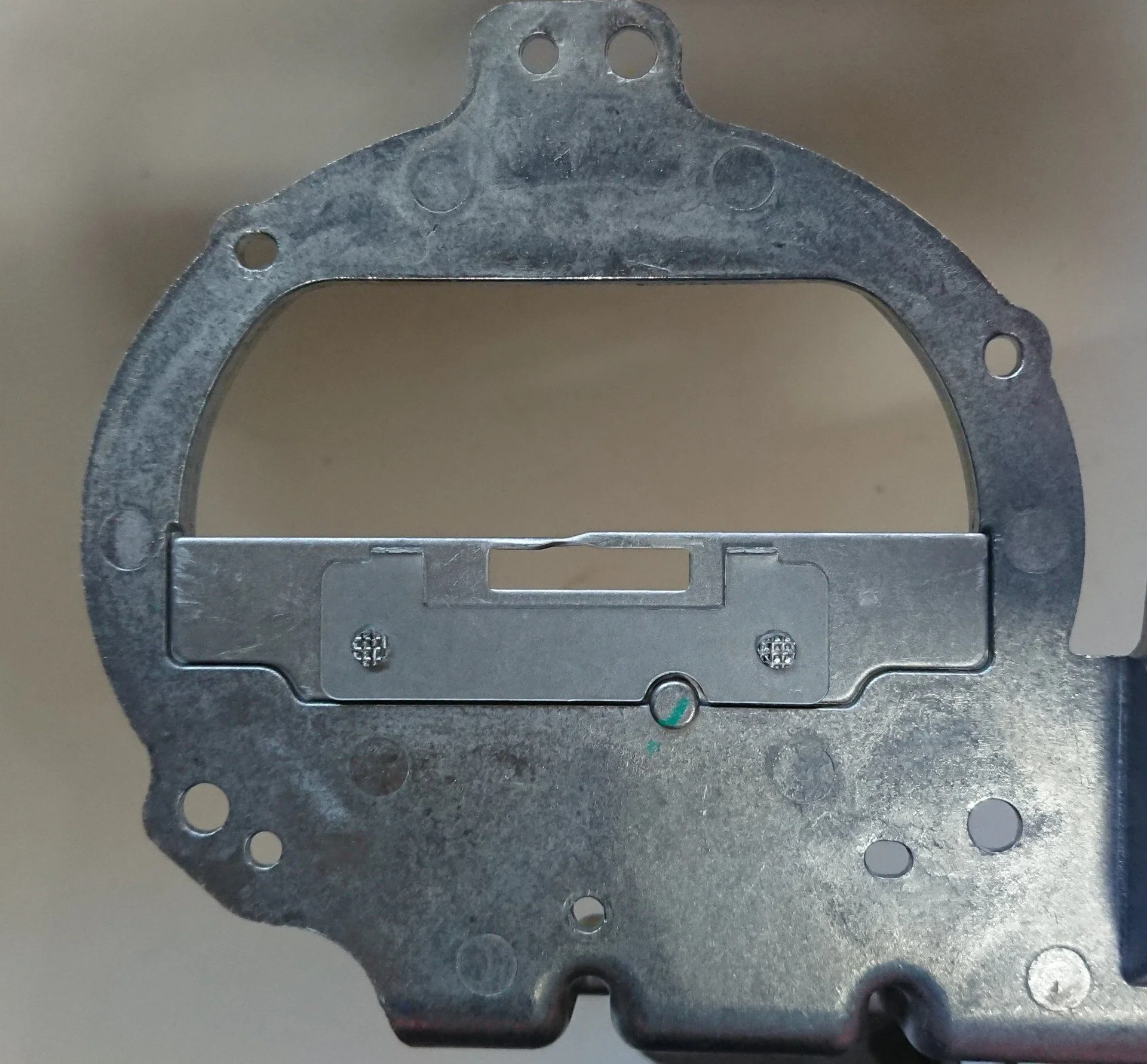

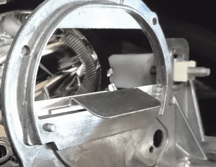

se7enine - The stock headlight projectors however have a tab that produces a glare that needs to be bent out of the way and coated with some dull paint to eliminate that glare.
Do you have any more details on this? I didnt see any obvious tab, but I do see the same glare.
The tab is similar to this. Even after it is bent flat the top still causes some glare near the cutoff. That's why I suggested painting the tab near the cutoff it to try and eliminate the glare.
You can't break it off either because there is a hole under the cutoff that will allow glare and unwanted light above the cutoff.
