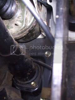

Gday,
As you can see from the pictures, i have a leaking clutch (master cylinder obviously) It doesn't seem to be leaking from the outside though, only the inside.... Can i just rebuild it? Also, i wouldn't mind getting a new booster while i'm in there, i've always had clutch issues. I found THIS thread, but i cant seem to find where he bought it..... Can you help me Boogie?
Thanks Guys

if ur clutch master is leaking u may find it impossible to find a replacement. See how you go but I couldn't find one and put in a rebuild kit. RooDogs help me out with the clutch master kit.

Just shopped around, the best i could do was an overhaul at ABS or the like... I'm just going to do that, might get my slave cylinder done at the same time.
Just been searching and came across the hzj75/79 clutch master. Looks like it will fit a BJ71 or 74 with a slight modification to the clutch line and heat deflector. Also the price is good. Well under $200. Check eBay and toyodiy for hzj75 clutch master cylinder.
I ended up having my master and slave overhauled with stainless sleeves ect, through ABS.
Was $195 for the master and $95 for the slave. Both are mint, they just didn't make a difference to my clutch. Still releases 1 inch from the ground ect. I need a new booster (still waiting on a response from summer), and i need a new clutch also......
