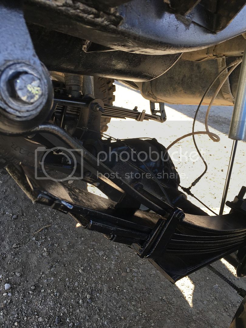

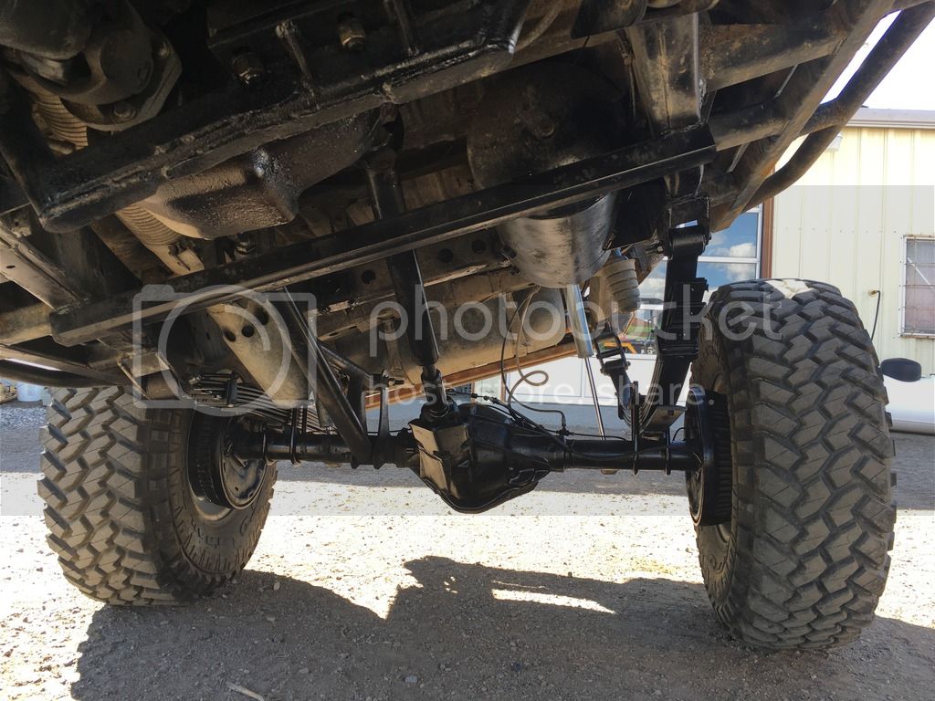

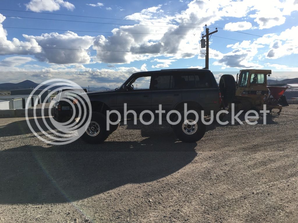

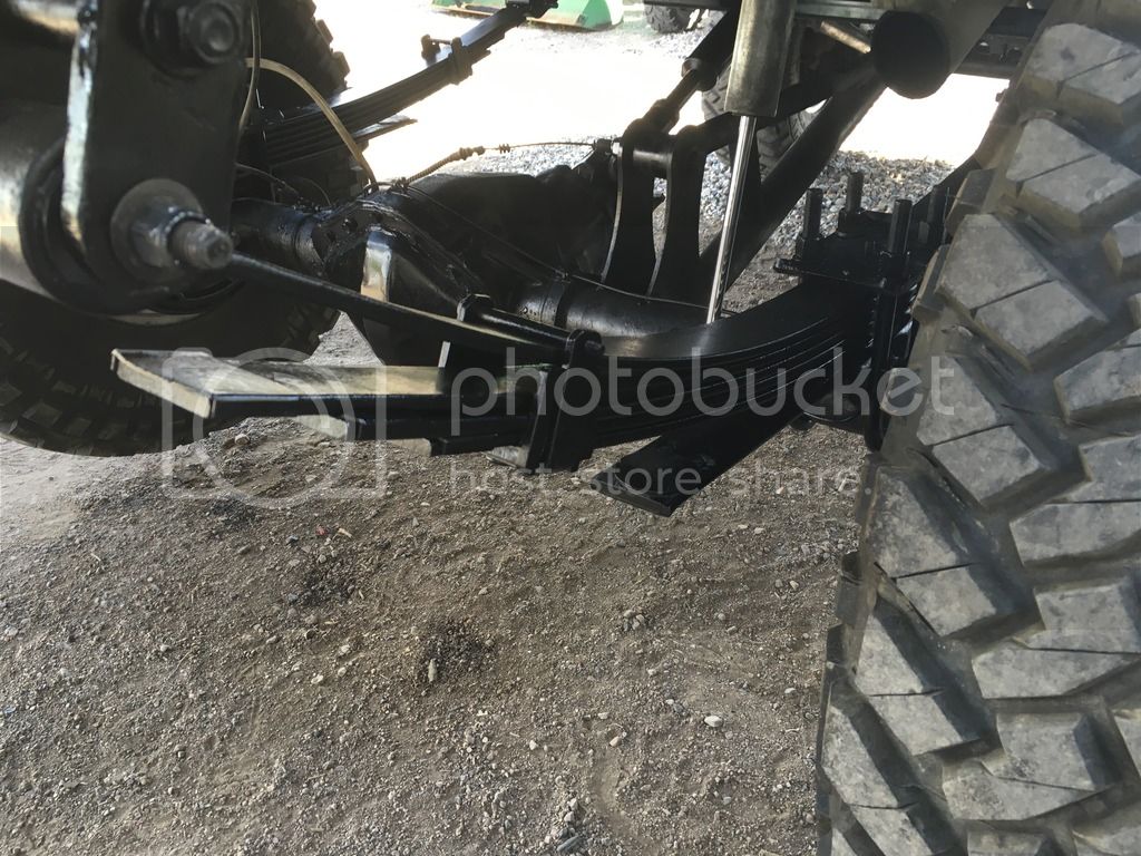

So my 1/2 ton 63" set up worked awesome off road, very flexy, no complaints. However, it was too soft for on road and then I added a tire carrier and some other stuff and it got to the point it was sitting a few inches lower than the front. I tried to bastardize the pack but that didn't work so well and ended up with some 3/4 ton 63" springs. These seem to hold the weight and handle better on the road and I can still stuff them but they're not as flexy unless I unbolt the clamps. I'm assuming that's probably too much weight for just the main to handle though and I'm concerned that I'm going to break the main off at the ubolt plate. Just looking for feedback and ideas.

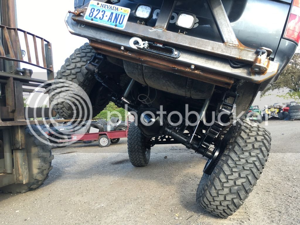

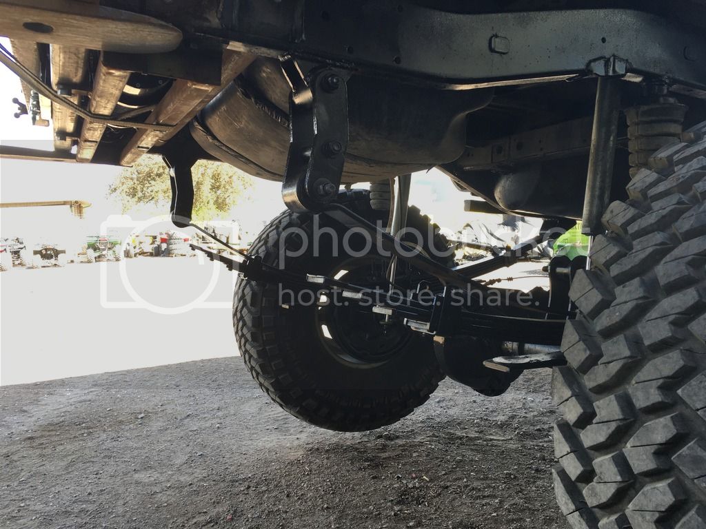

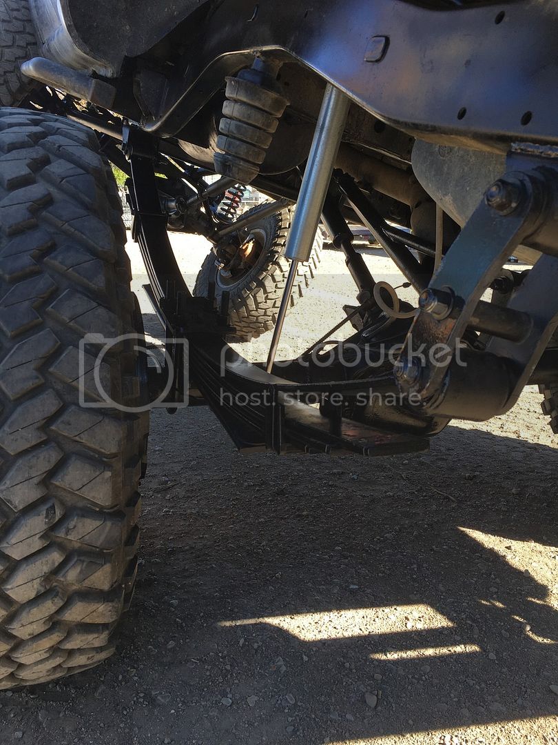

Full droop with the bolts in the spring clamps I was getting 11" of shock shaft showing out of my 14" shocks. With the bolts pulled I was getting 13" and it was easy to bounce a little on a tire to fully extend my shock. With the bolts in, I could bounce pretty hard and not use the full travel of my shocks.

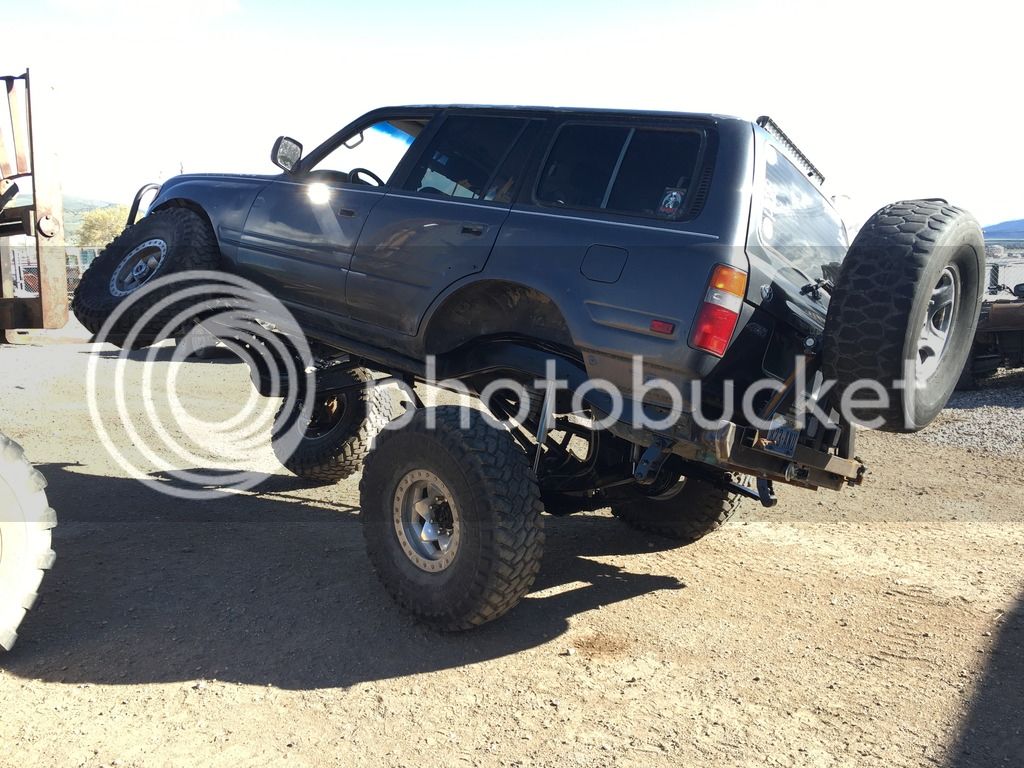

With the spring clamps unbolted, flexing one side, front or rear, I don't quite use all that shock shaft but I know I use all my up travel when I bottom out the rear. If I stuffed one tire in the front I would have 12" shock shaft showing on one side and a few inches on the other (and use up all 14" of my c/os in the front). If I stuffed one tire in the rear I would have about 10.5" of shock shaft showing and a few inches on the other side (and the front used all travel). Some or none of this may be pertinent, IDK, just throwing it out there.
The obvious answer here is to link the rear and that may happen in the future but for now I just want to get these leaves set up half decent.
So... bolts or no bolts? Will I break a main leaf? Can I add clamps else where? Should I? Would a longer shackle help? What else would change? I could probably raise the ass end up another 1" or 1.5". I may need to anyway. It is sitting pretty level for now.
