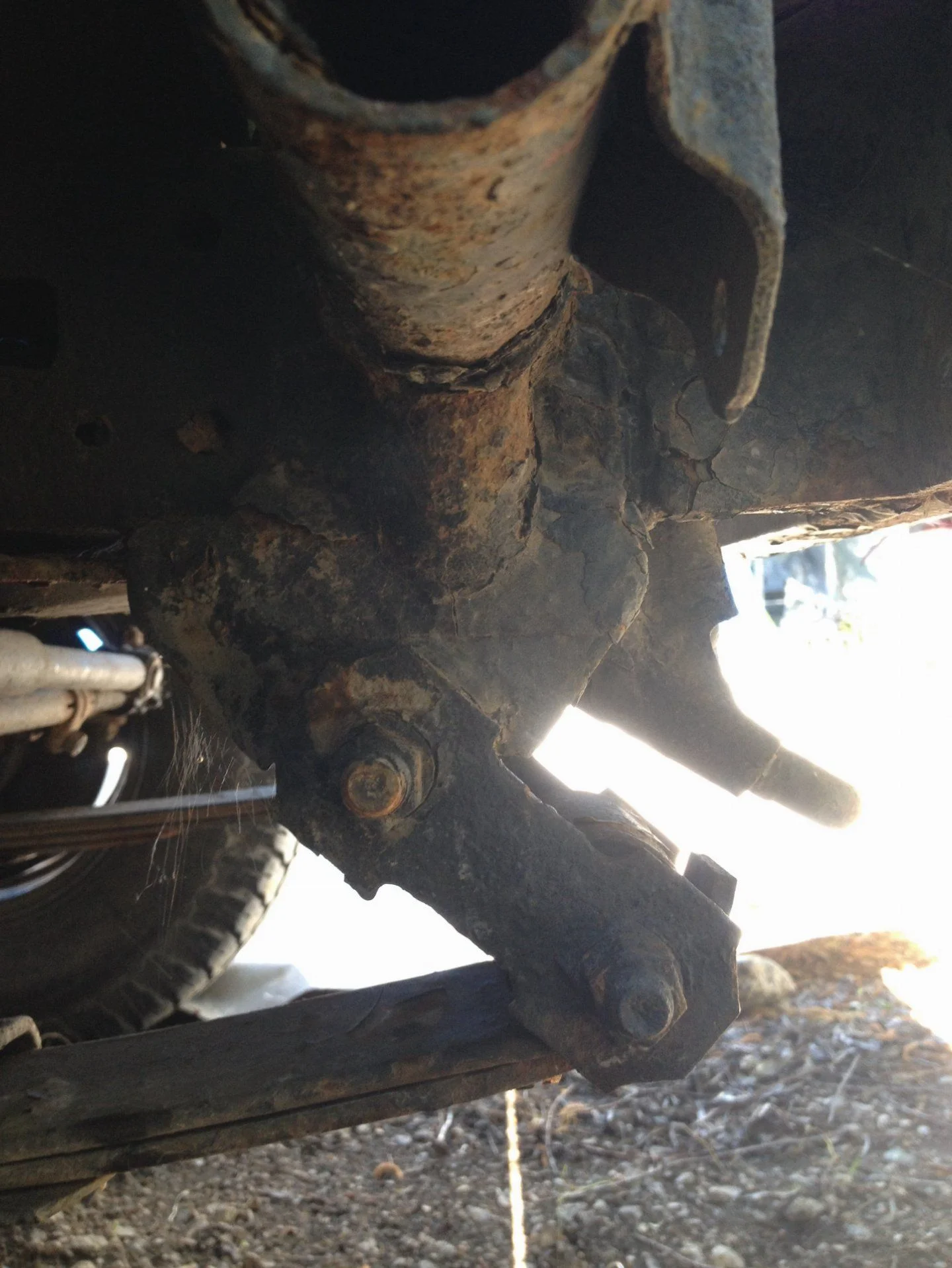

I recently bought a right hand drive 1980 FJ40. I noticed a few days ago that the left hand side (passenger side) shackle is hanging lower than the drivers side shackle when measured from the floor. The entire leaf spring on the left is hanging lower when looking from the front of the vehicle. They are not at equal heights. The shackle sizes are identical. Is this something to do with the frame or the leafs?
Also the fj40 leans to that particular side as well.
Recently replaced all bushings with OME bush kit. Checked u bolts as well.
Sorry if the pic is not clear. if u look from this angle will you only see the differences in height.

The spring looks almost flat. Look at the angle of the shackle and see if they are significantly different from side to side.

The springs do have a slight curve to them. The angles are also very similar. Cant understand why one side would sit different to the other. Also the fj40 leans to that particular side as well.
