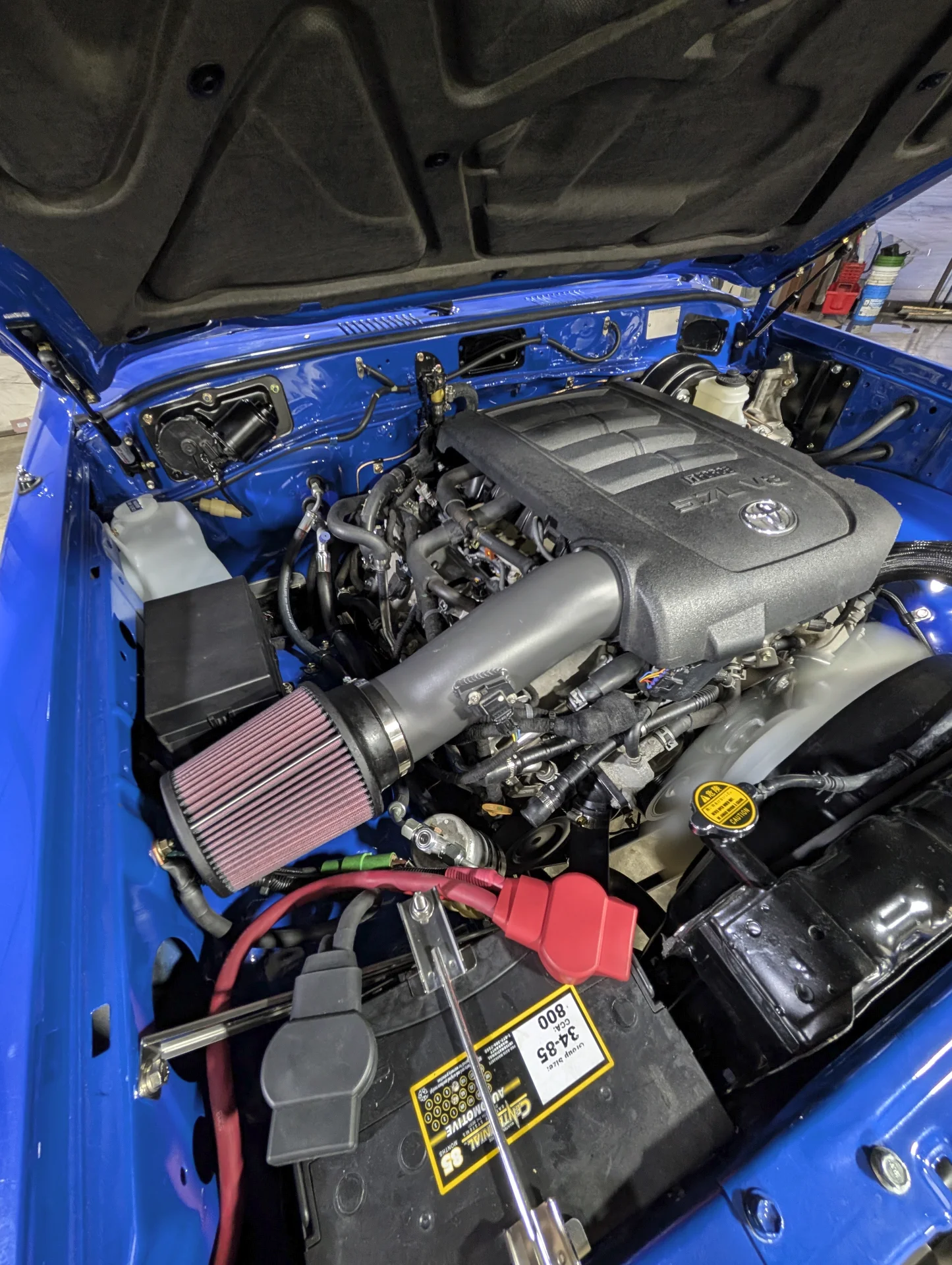

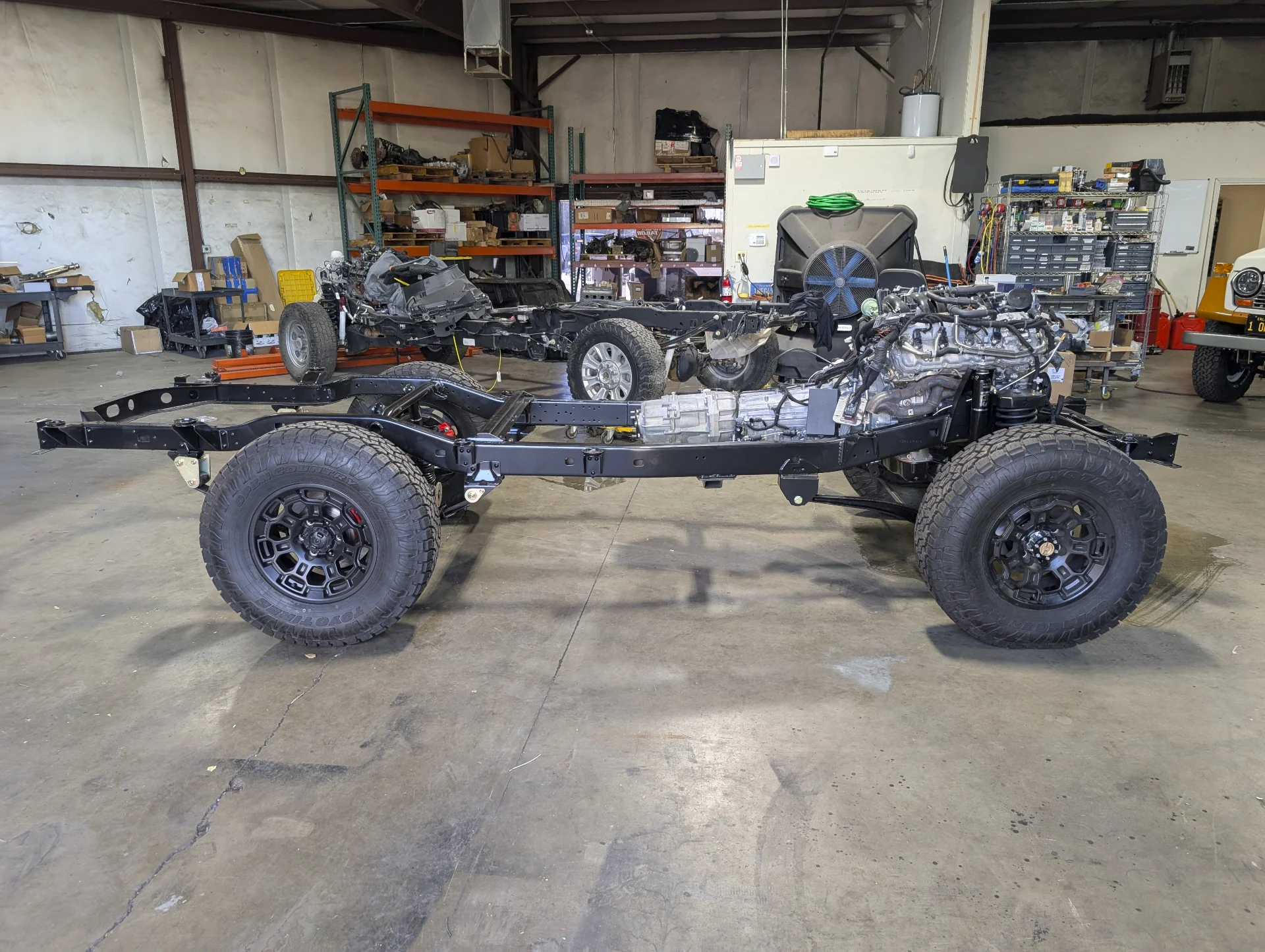

View attachment 4162502View attachment 4162503
Thank you! Your 60 build was one of the few that inspired this nonsense.
I'm aware it's going to be a tight fit, already lining up solutions to make sure it can be squeezed in there.
Next steps are for me to pull the cab off the donor, get measurements, and begin cutting down the frame into a test bench to run the 3UR 'standalone'. Looking to have everything sorted and ready to go before tackling fitment.
I'd love to pick your brain on how you got the whole system to run well and what you retained / lost.
