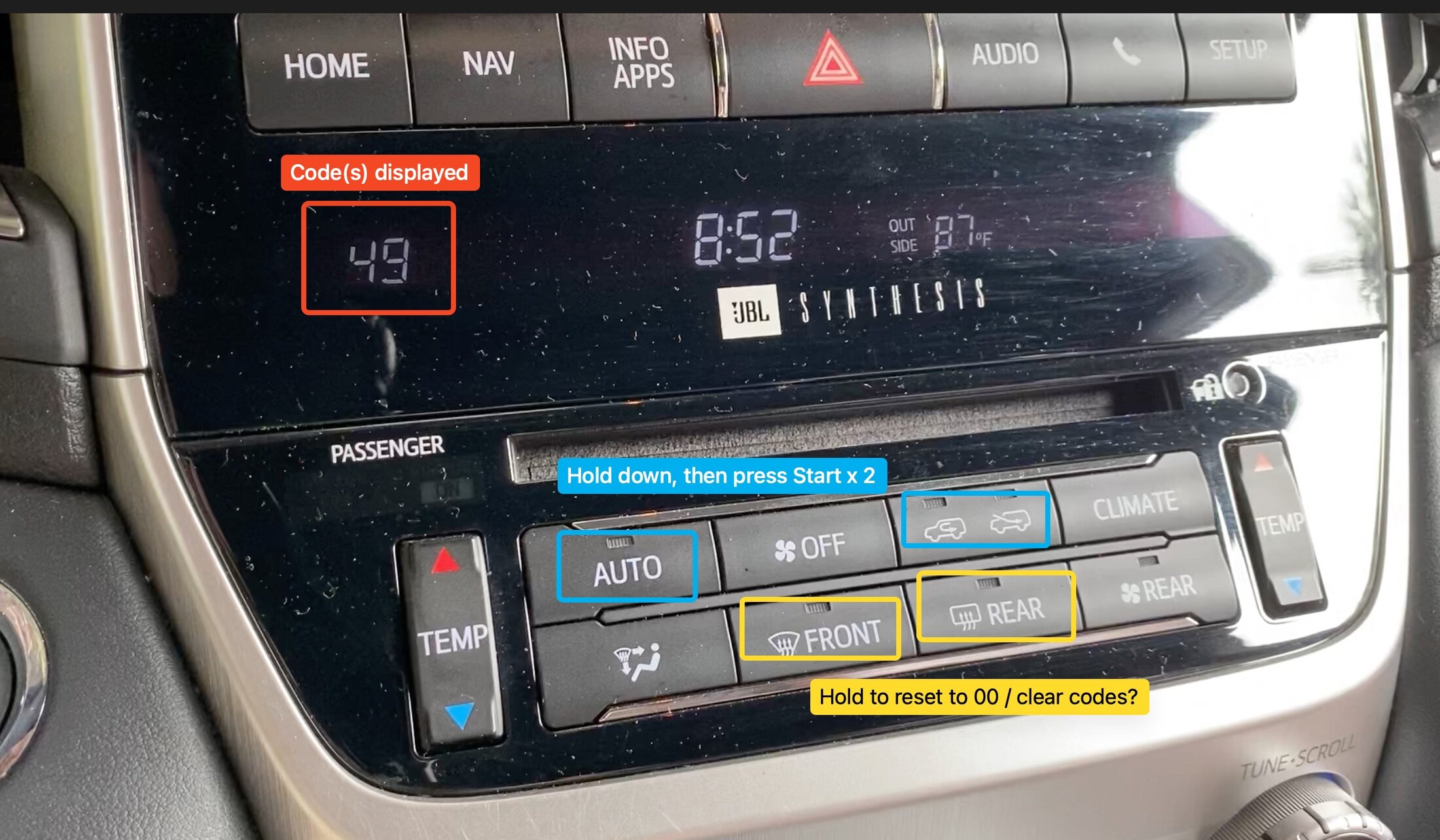

Hold down the Auto and Recirculation buttons then press Start x 2 w/o starting engine.
This should display any codes, mine is showing "49" and will not reset after holding Front and Rear defrost.
Code 45 on mine
Code 45 on mine
This is what I have found for codes. They all start with "B14" then the number like your 45 and my 49. Haven't dug in any more to see how to resolve the problem yet.
