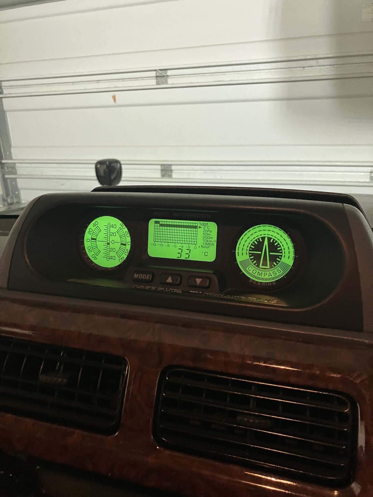

Hey 90 Series friends.
My Prado has a clock that doesn't function but does illuminate. Does anyone know if there is a common flaw on these to start with in diagnosis? The Haynes guide I have doesn't get specific on either item. I was thinking of using a voltmeter to find where the circuit is broken, but I'm not an expert.
I also have an inclinometer that functions but doesn't light up. I tried changing the T5 bulbs and the twist housings, and it still won't light up. I can see the instruments all function properly when it's dark outside and the headlights are off, as there seems to be the most minor amount of illumination somehow. But during the day - they just look dark.
Anyone have any ideas? Thanks!

Holding the Mode button will turn on the display light for the tri gauge

Thanks for the reply! Unfortunately, I tried several durations of pressing the Mode button (1, 3, 5, 7 etc seconds) and it wouldn't come back. I'm going to have to take the cover off again and see if I nudged something loose, and borrow a voltmeter from work. "fixing" things isn't supposed to make it worse haha.

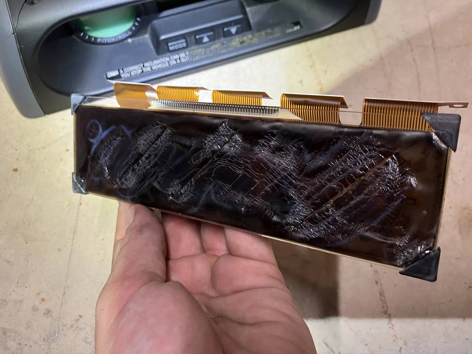

The old LCD screen is cracked in several places. I don't think there's any saving this one. I'm going to fit some analog "solutions" into the casing while I figure out a more permanent 12v solution.
