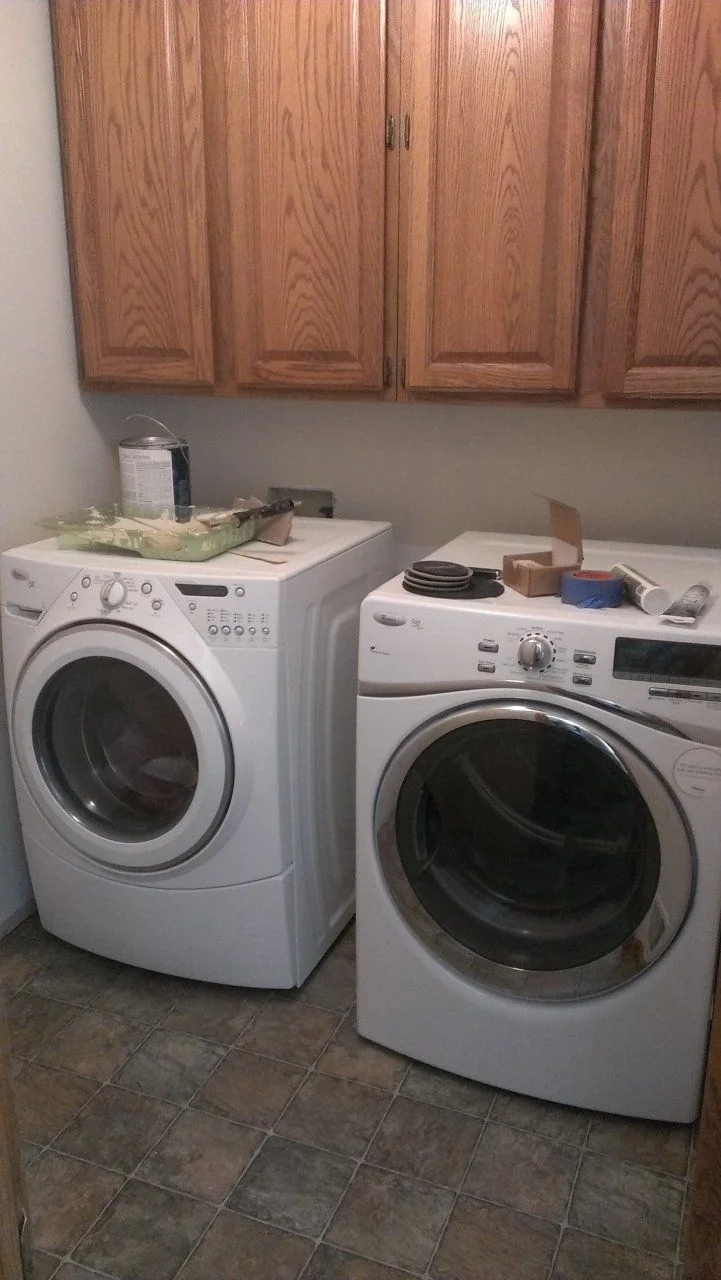

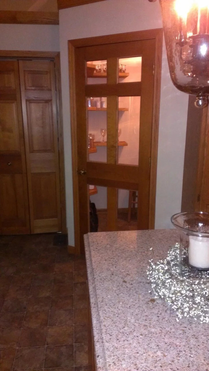

Our laundry room door is in our kitchen, near the door to the garage. It was a convenient place to toss shoes and hang coats, which accumulated. It had a big laundry sink, which didn't leave much room for the new front-load washer. After a year or so of complaints I finally ripped out the sink and cabinet, and as I feared that just meant more changes were needed, starting with patching in the floor.

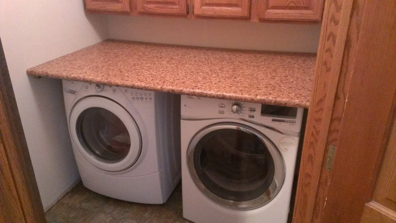

Next came a 36" wide peninsula somebody returned to the big hardware store: $50. I used a belt sander to sand the sides down until it fit snug between the walls, I used to build and install countertops like this.
Next we needed to cover the fronts, I came up with a lot of ideas, but then we found an oak bifold-door on Craigslist for $45. A bit more oak pieces for trim and support finished the front.

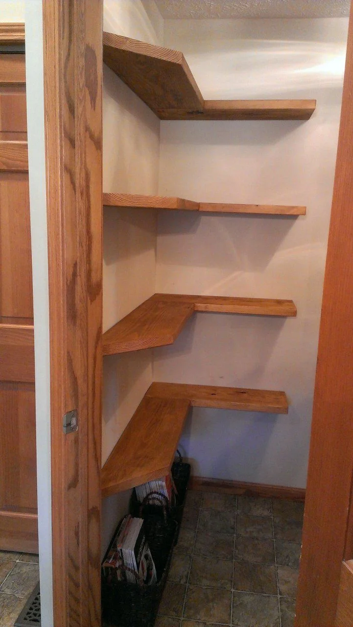

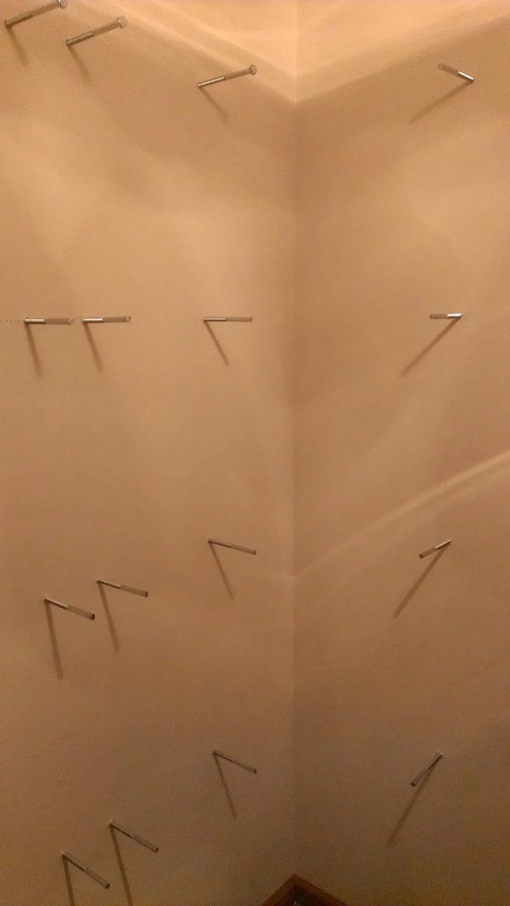

Next came shelves, I liked the floating shelf idea. Lag bolts with heads cut off slid into holes in the wooden shelves.

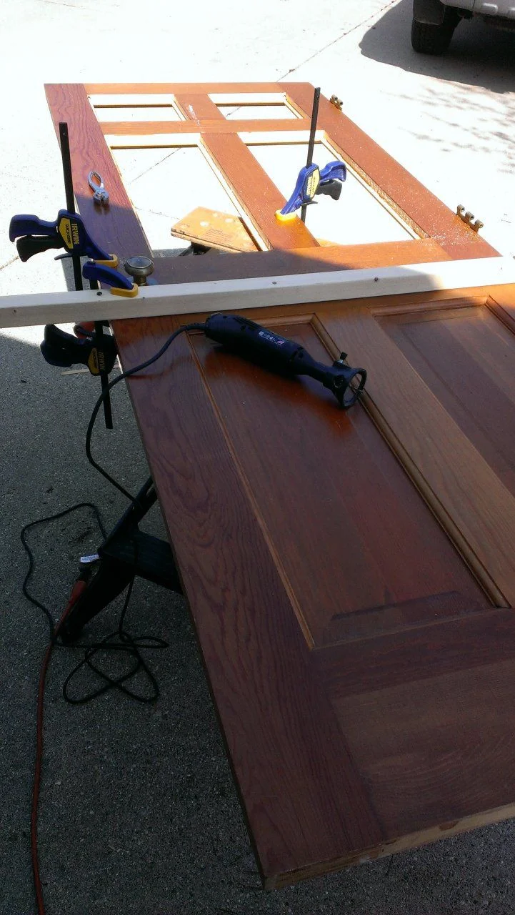

Then wife thought a glass-door would be cool, but I didn't want to spend $200+ on it, so I modified the existing door.

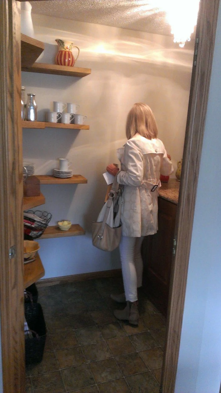

Clear glass gives the feel of a bigger and more functional kitchen area, which is my biggest reason for going through this. It is as much for show as practical. Beveled glass would have cost another $300, twice our total investment. A wine-room at a restaurant inspired the idea, but I don't think we would want to store wine in a laundry room. It has added a decent amount of kitchen storage, and forced us to hang up our coats in the closet. The countertop is plenty big for folding clothes, something we needed.
